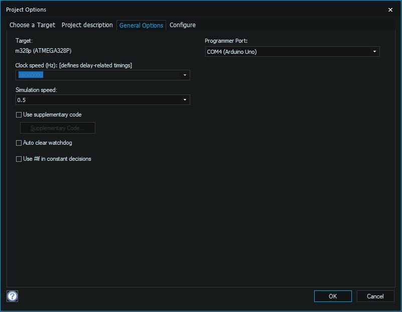

I am having trouble getting any project to run on an Genuine Arduino Uno R3, it appears to upload ok but won't run. I am making sure the build is set correctly best I know but still no joy. Have re-loaded Flowcode still no go. I am using the compile to chip button on top bar to upload. It works perfectly with the same flashing LED if created and uploaded using the Arduino IDE 2. I have tried to send a copy of the file but it doesn't seem to attach. Should it.

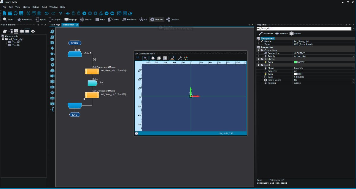

The LED won't flash because the pin will be high for 3 seconds, then go low, but it will then instantly go high.
It will look like the LED is permanently on.
You will need to add another delay below the TurnOff()

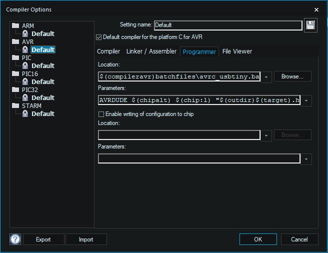

I have done all you suggested including a full database update. Nothing still works on any file including also PIC ones. The Arduino Uno has flashing leds while uploading but when finished has the led on pin 13 onboard led fully lit not flashing. As previously mentioned a sketch written in Anduino IDE2 loads and works as expected.
Do I have to modify the compile options boxes from default. If yes could you please give me an example.
Do I have to have AVRDude if so where to locate it.

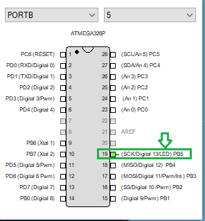

To control the onboard LED, you have the wrong pin selected.
This should help After changing the properties from D7 to B5, the onboard LED flashes every 3 seconds for me on my Uno

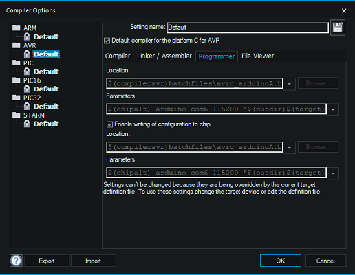

If you try and modify the settings, they should be overridden with the default settings again, after closing and opening compiler settings.
Your compiler settings look wrong.

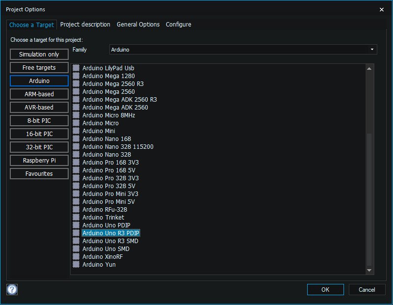

It looks like you have chosen Atmega328p.
If you have then would match your compiler settings.
However, with your other image, you are showing Uno R3.
My advice is to change the target to a different target, then back to Uno R3.
Makesure they match my settings: I would still like to see your New Test.msg.txt file.

Thanks so much I can't understand how looking at it so much and trying so many things I didn't pick up I had confused pin numbers and IO numbers very embarrassing.
