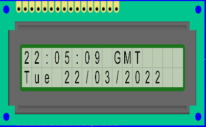

In FC9 I created a display that shows time, & date on an LCD.
You can easily adapt it for a VFD.
The post is here.
The post is here.

Re: pic16lf1824 Clock with DS3231 and VFD display ( PT6315 )
I have made some modifications for you.
Unfortutunaly there is a bug that has stopes the RTC from updating with PC time.
That has now been fixed and should be pushed out tomorrow.
- RTC Example v1.fcfx
- (44.8 KiB) Downloaded 148 times
Hi the RTC simulation fix was pushed yesterday.
You will need to use Help, Check for updates, then reload flowchart after update has been completed.
The flowchart I posted was just a guide on how the time and date can be formatted to look correct.
The flowchart also calculates the day of the week as within the RTC it's only a number that is set, then automatically incremented.
The RTC has functions that allow you to set the time and date.
I would suggest that first, you create a one-second flasher to check the microcontroller is running at the correct speed.
You could then learn how to use Fowcode from Introduction to microcontroller programming course within The learning section.
You don't require the hardware as you can use the Flwocde simulator.
It has been updated for Flowcode v9, but you should be able to complete the course using Flowocde v8.
Alternatively, there is the Flowcode - Getting Started Guide from the same learning link.
once you learn how the switches work, you will then be able to create your own flowchart having only the functions you require.
