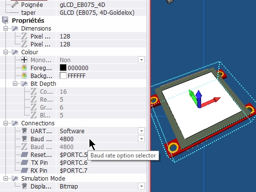

2. I loaded the example from Matrix (program name: EB075A_v7.fcfx - it works perfect in flowchart simulation) into a PIC16F877A (installed on the EB-006 programmer) and .... no communication... and no reaction on the display.
3. I did change the BAUD_LIST parameter to 9600 in the display component macro to match the OLED display settings, and still no luck.
Not sure what I am missing here...

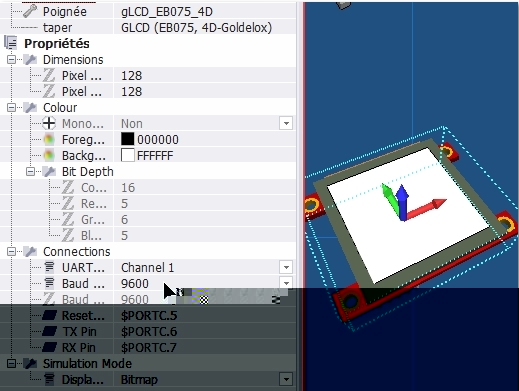

I did manage to communicate to the 4D uOLED (1.5" and 1.7" displays) ising the UART component, and it works as intended.
Now, I can conclude that the existing GLCD EB075 GOLDELOX component is malfunctioning.

First, I just started to use Flowcode7, zero - experience. I did like the interface - quick to program and easy to test and troubleshoot.
Therefore, I could not figure out yet, on how to edit component macros, how to get to the C code and alter it. I would love to get a hint on how to do it. I did watch the LED component creation video, but does not contain any macros examples. I will keep reading/looking.
I did TEST the NEW component you created on "uOLED-160G2" hardware.
Some observations:
1. The Baud speed does not get updated: even if changed, it stays at 57600 (and confirmed working at 57600).
2. The simulation coordinate system will have to be updated somehow to match the row and column as you indicated in your notes. (Please see the attached picture and thanks for the details)

My 4D 128-g2 display on an EB075 board works with a 16F877A in "channel" mode but can not be run in "software" mode; the transmission speed is limited to 4800baud.
Screen Shot 02-19-18 at 04.34 PM.JPG (117.06 KiB) Viewed 35136 times
Screen Shot 02-19-18 at 04.22 PM.JPG (124.99 KiB) Viewed 35136 times
With an ECIO40 on the portC with a redirection (patch) of RES on RC0; I can not operate it in "software" mode with the good speed of 9600baud. Maybe incompatible with the ECIO40?
I also tried with an AllCode with the following connections (see photo) but unsuccessful.
Do you want to give me a track so that I can progress and integrate it is GLCD in my project with an ECIO40 and an AllCode.
Screen Shot 02-19-18 at 04.27 PM.JPG (49.61 KiB) Viewed 35136 times
thank you in advance
Bruno

Hello, everybody,
No one to answer my problem; how to change the transmission rate to 9600baud instead of 4800baud compatible with the glcd128g2 in "software" mode for the UART channel.
The display works very well with an ECIO40 in "channel" mode for the UART channel; it is indeed free to use! But can not use it with my AllCode because the UART channel is reserved for bluetooth!
It would be interesting also to be able to use the function "injector" for the simulation.
Thank you for helping me!
Bruno
Re: 4Dsystem 1.7' uOLED-160G2 OLED communication issue
Hi Bruno,
On the Formula AllCode device UART channel 1 is used for the Bluetooth communications. Hardware channels 2, 3 and 4 are free for you to use as you wish.
