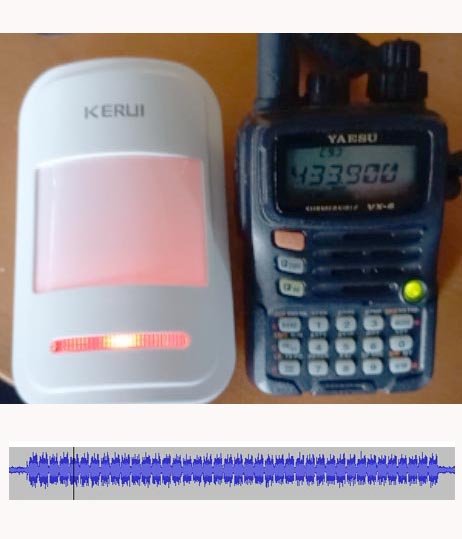

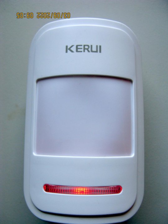

I will try to use the Chinese PIR sensor (433 mHz) Keuri brand (from Ali).
This sensor is designed to work with the dedicated Keuri controller.
I am not sure what frequency is used by this PIR sensor.
The band for it is: 433.4-473 mHz.
What UHF RF scanner can be used to get the PIR frequency?

I checked this frequency with PIR on/off, on/off... No carrier.

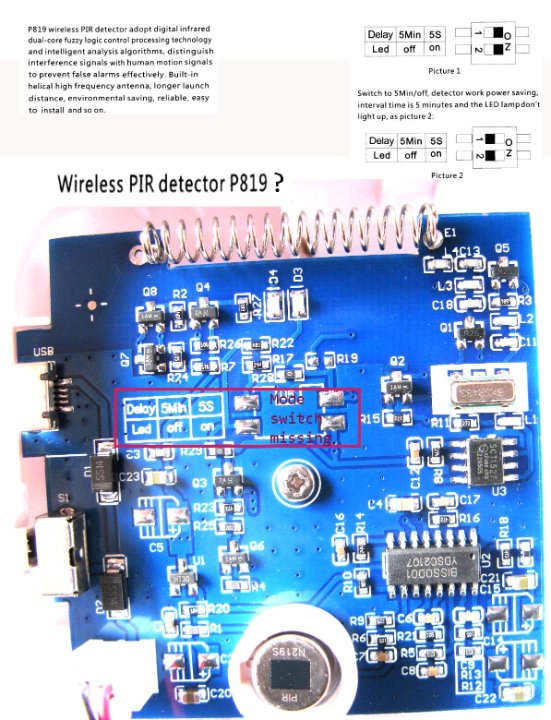

PCB
I found on PCB the:
SCT1527 OTP Encoder
BISS0001-Micro Power PIR Motion Detector IC
Looks like the 433x.mHz rf amplifier is not on chip, but on transistors.

Kerui P819 manual: 315/433 mHz +/- 75kHz

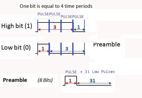

I think (can be wrong) the device uses ASK mode, some kind of Morse code with carrier modulation.

Re: Decoding the TTL RF signal
This is another problem.
I think I am moving in a wrong direction.
Encoder/decoder should be from the same 'family'.
SCT1527 OTP Encoder (Keuri PIR) will not (probably) work with HC-12 decoder (MCU STM8s).
I read that some people use the SDR receiver and analyse the code...

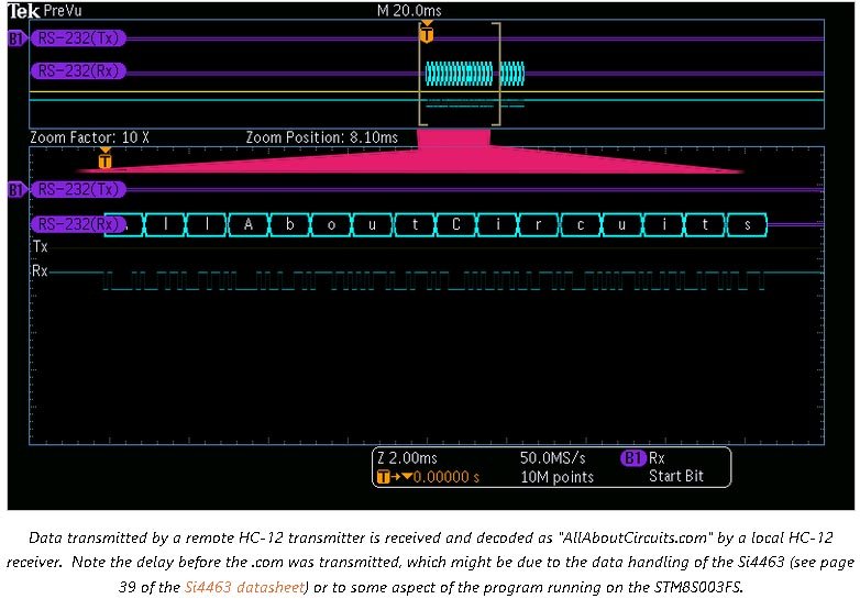

Manual says: Working frequency range (433.4-473.0MHz, with 100 communication channels, stepping of 400kHz)
Rx code example is attached.
https://www.allaboutcircuits.com/projec ... er-module/
Doesn't look like the code has address, etc.

Re: Kerui PIR frequency.
chipfryer27 is correct.
Tx,Rx freq is 433.92 mHz.
Will check the videos.
- Kerui-2.jpg (54.26 KiB) Viewed 276807 times

Rx the TTL data from 433mHz sensor
Working on a code for 433mHz sensor data( rx only).
I used the IDE Arduino with RCSwitch library and looks like it works.
I can receive PIR information.
Now I need to make the FC8 program.
The TTL data format is:
protocol 1
pulselength = 350,
Sync bit = 1, 31
"0" bit = 1, 3
"1" bit = 3, 1
nvertedSignal = false
How to find the preamble
As I understood the code should flow (for Nano) as:
If Int0 (pin D2) has High
interrupt = 1
rx_state = 1
Start counter
Count 350uS,
If D2 value = 0
Stop counter
Get the microseconds and compare the result
Start counter
Count 350us 31 times (after sync bit pause)
Stop counter
As TTL data packet repeats several times, do it again.
Am I in the right direction?

Re: HC-12 433 mHz module + Ard + Kerui PIR
From the limited info I have on the 1527 it does look like a High has a ratio of 3:1 with a Low having 1:3 time periods. However I haven't found anything yet to suggest what these periods are. I suspect whatever is sending the data will be defining them.
The Preamble looks like a ratio of 1:31
So for example lets just say the time period was 250uS. It would take 4 x 250 = 1ms to send a bit ( 1 = high for 750us, low for 250uS or 0 =high for 250uS, low for 750uS ). Preamble would take 32 x 250uS = 8ms (high for 250uS then low for 7750uS).
If I had a scope I'd see what was coming out of the module and using the ratios establish the timing from there.
From that it should be relatively straight forward to get your chip to interpret.
I stress I haven't used the modules and I have limited info so I might be talking nonsense
Hope not though....

Just a thought. I see 1527 decoders are available quite cheaply.These appear to pair with a transmitter and provide a 4-bit output, which I am assuming are the last four bits from the 24-bit signal (address+data). Maybe these could be used as they may simplify things (although if using multiple Tx then a method to identify each one would need to be implemented)
Nano should be able to decode the full 24-bit string though.
I'm assuming the 350uS pulse length is the length of a bit / 4, if I've not misunderstood.
1 = h,h,h,l = 1400uS
0 = h,l,l,l = 1400uS
Preamble = h,l,l,l,l,l,l,l,l,l,l,l,l,l,l,l,l,l,l,l,l,l,l,l,l,l,l,l,l,l,l,l = 11200uS
Late at night rough (very) thoughts are
Identify preamble
Receive and store the next 24-bits (perhaps in an array)
If message is repeated "x" times then
Receive and store the next 24-bits in array #2
Repeat until message stream ends (array #x)
Perhaps compare the received messages and discard if all different, or proceed if say two out of three match? Maybe that doesn't matter and the Nano will respond to any matching address? Many options.
This link may assist, but confusingly it suggests preamble is a high for 350uS then low for 10mS (although I get a feeling that accuracy isn't the strong point of these modules)
https://www.microchip.com/forums/m1133876.aspx
Identify preamble

350uS pulse length is the length of a bit / 4...
I believe it is. If one bit = 4 clocks, the Preamble High pulse = 350uS+31 Low(350*31), the High bit pulse = 350*3=1050uS+ OneLow(350uS), the Low bit pulse = 350uS+3Lows.
Identify preamble
I thought
to flag the preamble by using Timer2.
If D2 input = 1, start Timer2, count.
If D2 input = 0, stop Timer2 and save the value to variable pulse_high_duration.
Start the Timer2 again and count until the next High pulse will come. Save the value to variable pulse_low_duration.
Save both values to variable preamble duration.
Example:
Preamble High duration = 350uS, Preamble Low durat. = 350*31=10850.
Preamble duration = 10850+350 = 11200uS (as you calculated)
If this variable < 11400 >11000, flag the Preamble and
Work with 24 bits.
if D2=1. Start Timer2. Count. Save to variable pulse_high_duration. Stop Timer2.
If D2=0, Start Timer2. Count.
If D2=1, Stop Timer2. save the value to variable pulse_high_duration.
If variable pulse_high_duration > 300 < 370, AND
If variable pulse_low_duration > 1100 < 1000
->Save 0 to buffer,
Else
If variable pulse_high_duration > 1100 < 1000 AND
If variable pulse_low_duration > 300 < 370
->Save 1 to buffer
If bits count = 24:
Flag the end of the 24 bit, ignore the other packets and wait for the preamble again.
Be ready., or make a pause...
If device Tx the ttl data, get it again.
Identify preamble
I thought
Example:
Work with 24 bits.
->Save 0 to buffer,
Else
->Save 1 to buffer
If bits count = 24:
OK I seem to be on the same page as you with what is being captured.
You could certainly use timers to count pulse duration and if "near enough" then accept it as whatever. Alternatively you could sample in the middle of a time period and take this value. This helps to negate jitter/wander/length-of-pulse issues.
Using 350uS as time period and a bit length of 4 x 350uS = 1400uS
For detecting a "1" (h - h - h - l)
Detect high (beginning of pulse). Time = 0
Wait 1/2 time period and sample (Time = 175uS). Value = 1
Wait time period and sample (Time = 525uS). Value = 1
Wait time period and sample (Time = 875uS). Value = 1
Wait time period and sample (Time = 1225uS). Value = 0
For detecting a "0" (h - l - l - l)
Wait time period and sample (Time = 525uS). Value = 0
Wait time period and sample (Time = 875uS). Value = 0
(Instead of actually waiting and counting Time every uS it would be better to perhaps sample as part of an interrupt being called every 350uS from middle of first pulse etc. I'm sure you get the idea)
Your code would possibly be less complicated and less subject to errors. If waiting for transition and timing the interval, any spurious transition would lead to incorrect readings. If sampling in the middle of a pulse then the glitch would need to occur exactly at that uS to be registered at all. You could add in various checks as you capture to ensure validity. For example both "one" and "zero" begin with a "high" so the first, fifth, ninth and thirteenth sample etc should be high too.
If you know that you will have preamble then 24-bits of data, with the data repeated three times then it would be easy enough to capture all the data just by continued sampling. As your code would only be busy sampling every 350uS it's got plenty of time to process what's been capture so far between samples (it's a "one", end of transmission, garbage etc).

What to do?
One way -> use counter
2nd way (as you suggested) ->sample in the middle of a time period and take this value.
