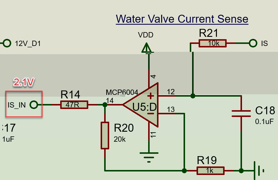

(3) programming the micro with the exsisting code(which is running on proto 1 the signal level drops down to 0.5V from 2.10V ,the 2.1 is the correct level of the signal.(the ADC pin must be draing more that 5mA).Pin IS_IN is the output from an gain amplifier to AN3 which measure the current in a watervalve circuit

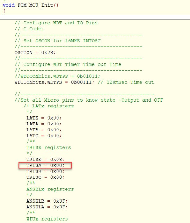

The only thing I can think of is if the pin is outputting a logic 0 to the pin. The ansel sets the input mode between analogue and digital. Maybe check the tris register and see what state that is in. It should be logic 1 for input mode.
The ADC component restores the state of the tris so if it was a 0 before sampling the adc then the 0 would be restored after sampling.

as you will see from the generated C code the TRISA is set at 0 's this outputs and my understanding from the datasheet is as yours
the ANSEL should be 1 to select Analog and the TRIS for the corresponding pin should be set a 1 as input ,The ANSEL A is set correctly

I would recommend that any pin you use for an analogue input that you initialise the tris bit to 1 instead of 0.
e.g. if pins RA0-RA3 are all analogue inputs then the init code should be.
TRISA = 0x0F;
In fact any pin that is not specifically used as an output should ideally have the tris bit set, this is the default state on reset so getting rid of the tris initialisers may simply solve the problem for you?

I am with you on this however this iniatilization code id Flowcode generated automaticaly , Would you suggest that I just before the main loop put some C code and intialize RA0 -R3 to inputs ?
Again you are to clever for the old man today :D
Re: Strange ADC behaviour
Hi Peter
Yep a c code icon before the main loop should do it :)
Let us know how you get on.

Issue solved setting the the ANx to Input with the ANSEL signal spot on current mesurement spot
