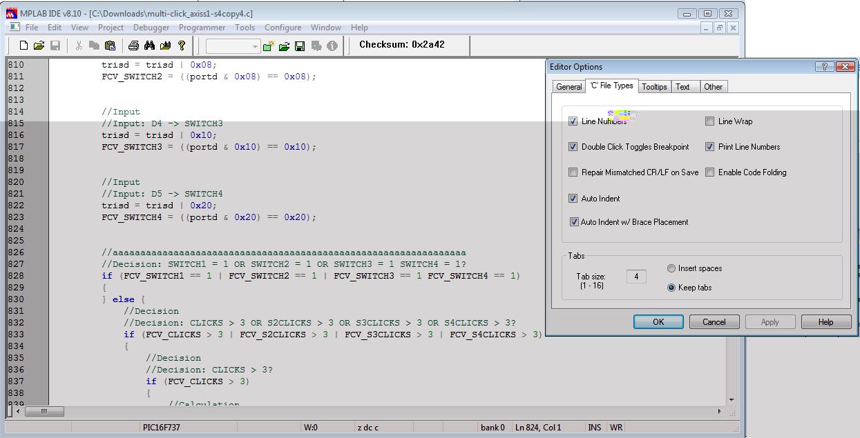

I know the problem has been solved by Steve,
However for any one who wants to know which line is causing a compile error:
If you run MPLAB IDE, open c file in editor, then editor will show all the line numbers. If not you can enable line numbers by right clicking on editor page or using Edit menu,
then select Properties, 'C' File Types tab, then select line numbers, and select print line numbers.

Re: Compile to chip error
You can do the same thing in a lot of text editors. Even in "notepad", you can use the "edit..goto" menu item to go to the appropriate line in a c file (note: you will need to turn word wrap off for this to work).
Thanks Steve, I used MPLAB and an example, since if people are using microcontrollers, they usually instal MPLAB as well.
However Notepad is not an option I thought of, but if u want a small freeware editior which following description form there site:
