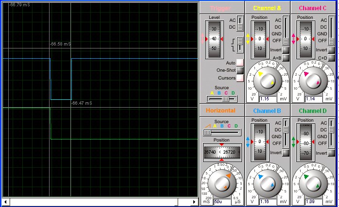

in the following picture of the oscilloscope, you will find 4 signals in 4 colours,
the green one not used.
the blue one is the led bulb that has come on, but does have a glitch at `B`
the red one is one servo, the `A` and `C`indicates the glitch.
the yellow is the other servo but still glitches.
Thanks in advance.

You can see both of these glitches in my picture of the oscilloscope in my previous post.
position `A` being the result of a `low` going output to some pin.
position `B` being the result of a `low` going output to some pin.( this pin is itself a led output)
position `C` being the result of a `high` going output to some pin.
It is interesting to note that when `high` going glitch effects the PWM signal it never cuts the pulse short ie. never interrupts the pulse in mid session... but causes the pulse to go high as soon as the pulse finishes...this low `spike` has got a width of about .02ms.
When the `low` going glitch effects the PWM signal, it does not keep the PWM signal from starting but pulls the signal down immediately it starts up.

Hi benj, i have done a bit more digging, i have tried to clarify the program and my problem by changing the 5 pin outputs to use port `c` pin rc5, port `B` /0/1/2/4 , but NOT `B3` the ccp pin!.... This may be of interest if you think the ccp pins are involved. The purpose is to take the signal out of the equation because the glitch happens on any pin. ie. the other led outputs as well.
THE SETUP.
I have still got the servo signal program working in the background if for no other reason than to give the program sufficient size for the pic chip to `clock` through. I have 5 led outputs as above. The program cycles LED `RC5` on-off every 2000 program cycles = roughly 1 second on proteus. The other leds come on if the servo end points are reached, they go off when end points have not been breached.
The cycling led on `RC5` going on-off is the control, the other led or pin outputs are to see if there is any interference.
THE RESULT.
In the below oscilloscope picture i have zoomed into on an incident. I have 2 signals, the bottom green one is the controlled cycling on-off led going into it`s off state.
The TOP blue line is at a time when a servo (RB0) had breached an end point and left there, therefore it is showing a high of 5v output.
NOTE: when the green control led goes off as intended, the blue high output also goes low for a fraction of a second (not intended) which on my PWM signal would be my glitch. The width of the glitch can be seen to be 0.11ms (more accurate reading than i took before), this may be of interest as a `clock cycle rate` could be calculated which may be of interest, i myself do not know the maths to do this.
I have not been able to get it to pulse high though, so i think the glitch high i was getting before may of been just a function of a low going glitch with other factors involved.
Hope this helps.

HI benj,
To start off, i have found an extra `output macro` some where in my program, i thought it was deactivated by using the `mask` and unticking all bits, so now i have deleted this in case it made a difference...... Strangely it did :!:
I have now re run the various variations using the `output macro`, the ` ADC` components.
selecting ports by using `C` code " clear_bit(trisc, 0); set_bit(portc, 0);"
and lastly also using the `C` code, set_bit(latc, 0); clear_bit(latc, 0);
The 2servo signals program working with NO leds or OTHER port outputs programed in. RESULT: = steady pwm signals. NO glitching.
I first added 2 `output macro` components to output onto port C, RC0 & RC1, but setup not to output anything, this was done by selecting mask and unselecting all bits. Note also that i have NOT got a port/led pulsing every other second. RESULT: = GLITCHING PWM signals, and as expected no leds come on. Why it has a glitch in this setup is strange as it should be the same as not adding any `output macro` at all :!:
I then activated the mask. Same setup as above but selecting bit0 and bit1 by `ticking` them on the mask. The RESULT: = glitching on PWM signals. 2 leds also come on and stay on as there is no program code to switch them off yet.
REPLACE WITH `C` CODE.
I then DELETED the `output macros` and replaced them with `C` code, `clear_bit(trisc, 0); set_bit(portc, 0);` and a similar one for the other output, `clear_bit(trisc, 1); set_bit(portc, 1);` the RESULT: = NO GLITCHING. 8) Two leds come on as the servos reach there endpoints but stay on as there is no code to switch them off yet.
I then, using `C` code, added a led to go on and off every other second (proteus time) by doing 4000 program loops before toggling the led on/off. Also added more `C` code to switch off the servo-end-point leds to go off with the pulsing-one-second led when it goes off. This result: = NO GLITCHING. :mrgreen: :mrgreen:
CONCLUSION
It would appear that the glitching problem is now resolved by using the `C` code, although i tried this earlier on and found it still glitching, this was likely due to the extra `output macro` found amongst the program code, even though it was deactivated.
It would appear that because the `output macro` just sitting amongst the program code can cause the glitch and NOT what it actually does, is the culprit.
USING THE `LATC` `C` CODE.
I replaced the `C` code `clear_bit(trisc, 0); set_bit(portc, 0);` with the `set_bit(latc, 0); clear_bit(latc, 0);`.What i found was, the port would not come on unless i used the `clear_bit(TRISC, 0); before the `set_bit(latc, 0);`
Q. is this correct?
Another strange observation is: I have a small `macro`, it contains a normal `output macro` that flashes a led 5 times to come on BEFORE the main program loop starts, it only runs this once and is never used again, it indicates the device has been switched on. The strange thing is, i DO NOT NEED to use `C` code, `clear_bit(TRISC.0) before i use the `set_bit(latc, 0);` even though this part of the program is way into the main program loop. :!:
The other `latc` port bits i still have to use the associate `trisc clear` `C` code.
Q. would you expect this to happen :?:
Using the `latc` `C` code also RESULTED := in NO GLITCHING on PWM signals. :mrgreen: :mrgreen:
I have tried the alterations to my program on the actual pic 18F2620 -all be it on one servo-and it works great. So i will now finalise my program, then blow the pic chip, test, and let you know how it turns out.
I don`t suppose the `output macro` can be sorted out with the `C` code correction could it :?: ...be good to have in the flowcode v4!
