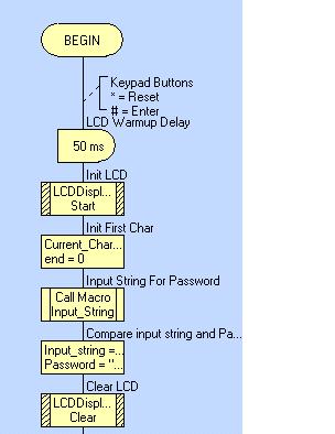

Hi there,
i was wondering if someone could explain me some of the things which are used in the following .fcf attached file.
I'll post what i think the most components are for, as flowcode newbie :P :
*The 50ms means for the LCD to 'warm up'
*The Component Macro below is used for the LCD to start up and erase all the previous.
*The 3rd component is something i don't know what it's used for, this is what it contains :
Current_Char = ' '
end = 0
valid = 0
*The 4th component i think is used to remember the the password that is entered in the next component macro, this component contains 'INPUT STRING'.
*The 5th Component is just to adjust the password, this contains, i think the Valid = compare also allows the user if the password is correct it is valid.
Input_string = Left$(Input_string, 3)
Password = "123"
valid = Compare$(Input_string, Password, 0)
*The 6th component is used to clear the LCD, but i don't really know why its placed there.

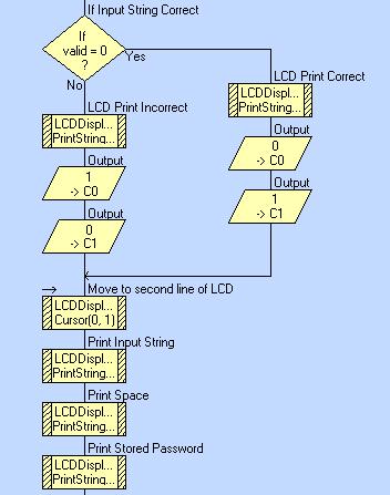

*Then we come to the Decision, this will control the both Relais used. if its correct it will active a certain relais, if its wrong it will activate another one. This will also give the Password correct or password incorrect to the LCD.

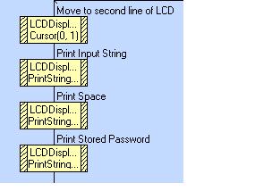

The component below are used to adjust the position of the correct/incorrect and compare the wrong/correct password given in, not sure about this.
And to be honest i don't really know what the next load of component is all about. i see an input variable for the Keypad but i really have no idea what all the rest is.

Hello
This is just to ensure that the chip has started ok. If you have a noisy reset switch then adding this delay can help with performance. However it is not essential to include this delay.
This is simply ensuring that variables get reset to 0 or strings get set to null.
This calls a flowcode software macro that is essentially another flowchart window similar to the main. In this macro is a routine to create a string based on keypad presses.
Once the string is collected it is compared with the "Password" string and the result is placed into variable valid.
Depending on the state of the valid variable selects the outcome of the program which decides to accept or reject the password.

I still have a few questions. i've said this about the decision : *Then we come to the Decision, this will control the both Relais used. if its correct it will active a certain relais, if its wrong it will activate another one. This will also give the Password correct or password incorrect to the LCD.
is this correct said ?
And if u can, could u please explain the other flowchart, but it doesn't need to be discussed all to the point, just the basics if you want.

Hello
Basically C0 and C1 could be connected directly to a red and green LED. The green LED would only come on when the password was correct. C1 could also be connected to a relay to allow for a electronic latch or similar to be opened.
The input string macro is a simple loop that repeats until the end variable is not equal to 0.
We then simply check the keypad and based on the keypad button press we decide what to do.
If the press is * then clear our input string to start over.
If the press is # then assign the end variable a value to exit the loop and perform the comparison.
If the press is under 255 and not * or # then we have a numeric keypress. Add the ASCII data to our comparison string.
At the bottom there is another small loop that forces the program to wait until the key has been released,. This means we only enter one character rather then a few thousand when pressing the keypad button for any length of time.

Could u maybe give a bit information about these 4 components. that's the only thing i don't understand yet from the MAIN chart.
Thank joe again
Steve
Azii
Posts: 25
Joined: Tue Mar 03, 2009 12:13 pm
Re: Keypad password Questions
Post by Azii »
I think the LCD cursor is just for the x,y position of the number you've typed and the correct code next to it.
the LCD printstring is used so u can see what u have typed on the LCD
the Printspace is just a macro used to have a space between what you have typed and the correct number of the input string.
the Print stored is used so it remembers the password what is give at the input string.
Password = "123"
is this correct or near correct? :D
Hello Azii
Yes your explaination of the program looks correct.
