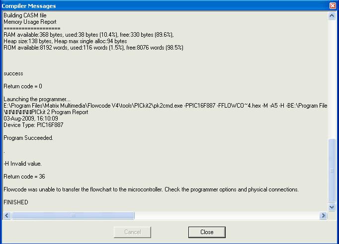

Hi! The Program Flowcode 4 Demo does not compile directly to chip, is the error message (in the screenshot).With program FlowCode3 there are not such problems .
Sincerely, Alexander

- flowcode4-problem.jpg (43.76 KiB) Viewed 5300 times

In flowcode 3 options writed:
Programmer Location
E:\Program Files\Matrix Multimedia\Flowcode V3\tools\PICkit2\pk2cmd_mtx.exe
Parameters
-PPIC%p -F%F.hex -M -A5 -H
In flowcode 4 options writed:
Programmer Location
E:\Program Files\Matrix Multimedia\Flowcode V4\tools\PICkit2\pk2cmd.exe
Parameters
-PPIC%p -F%F.hex -M -A5 -H -BE:\Program Files\Matrix Multimedia\Flowcode V4\tools\PICkit2\
What should I change?
Respectfully, Alexander

Re: Flowcode 4 Demo does not compile directly to chip
Hello
As mentioned in the FAQ topic to get PICkit working with V4.0 of Flowcode you need to....
Ensure that the programmer Location is set to the following.
C:\Program Files\Matrix Multimedia\Flowcode V4\Tools\PICkit2\pk2cmd.exe
Also ensure that the programmer parameters are set to the following.
-BC:\Program Files\Matrix Multimedia\Flowcode V4\Tools\PICkit2\ -PPIC%p -F%f.hex -M -A5 -R
Next ensure that the "Use external program to set configuration options" box is ticked.
Then below this are the location and parameter settings.
Location: C:\Program Files\Matrix Multimedia\Flowcode V4\Tools\PPP\PPPv3.exe
Params: -cs 2 -chip PIC%p -config
Thank you! Now is all right
