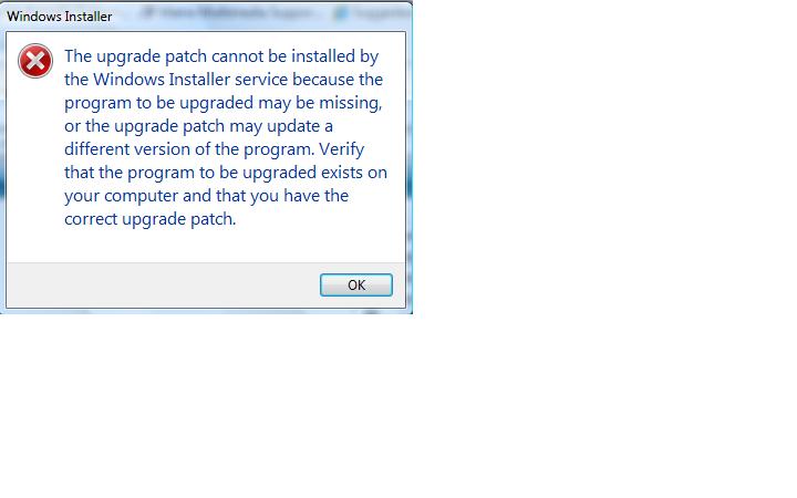

When run patch get a warning:
V4patch04 error.jpg (30.69 KiB) Viewed 4158 times
Does any one else have same problem?

You might get this if you're upgrading from the BETA of v4.2 to the release of v4.2. You should uninstall Flowcode and then reinstall it using the full v4.2 release.
Note that there will be a slight issue when upgrading from the v4.2 BETA to the release v4.2 - you should remove the following registry location before reinstalling to prevent corruption of the components toolbar:
HKEY_CURRENT_USER\Software\matrixmm\FlowCodeV4\Workspace

Thanks steve. You are correct. Version I was updating was V4.2.2.57 to the latest version.
Patch updated 4.1.1.55 to latest version. So is not a bug!
