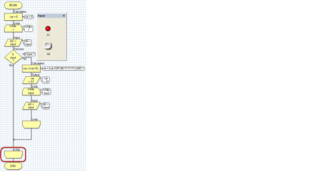

Don't know if this will help.
This is how I controlled o/p that is toggled each time i/p goes high. It does not wait for a switch to be pressed before carrying on, program is constantly looping so other functions can be performed. While switch is pressed, program doe not continue until switch is released, to avoid rapid nuisance toggling . Note: Using var = var XOR 0b00000001 will also toggle.
