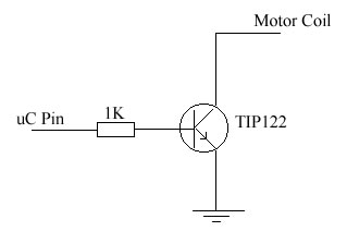

For a 5, 6 or 8-pin motor do as follows.
You will probably need to amplify the current provided by the microcontroller to allow the stepper motor to work. Running the motor coils directly from an output pin will probably not work.
The way I do this is to use NPN transistors as shown here, 1 for each coil.
The TIP122 devices are fairly inexpensive and can switch up to 5A per coil.
I then connect the common leads of the stepper motor to +V eg 5V or 12V depending on the motor. When a transistor connected to one of the coils is activated there is a direct path from the common lead to ground via the motor coil.
For a 4 pin motor you will need to use a H-Bridge configuration as each coil needs to be able to push and pull current.
