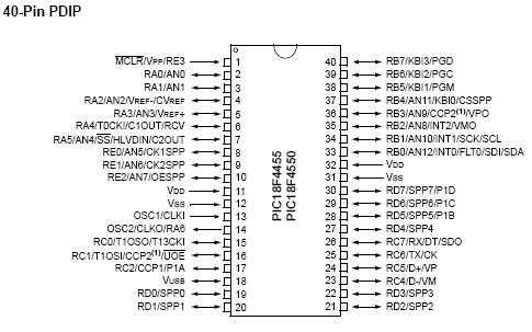

I noticed when selecting either ECIO28P or ECIO40P as the target, the resulting Chip Diagram's pin-out although accurate for the particular USB programmable device, is not the same as the actual chip being used (PIC18F2455 or PIC18F4455). The main problem really lies in how the Chip Diagram is labeled. Instead of stating the actual name of the chip, it should really say either ECIO28P or ECIO40P. I know this is a rather minor point, but certainly something that could cause great confusion.
Chip Diagram in FlowCode V4:
Here is the actual pin-out for the PIC that is being used on the ECIO40P:
