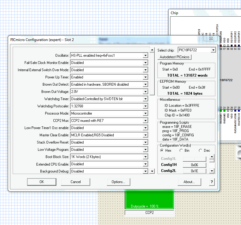

Hello Benj
The pwm not work on hardware if i set to pin re7
Please help
Regards Wolfgang

Hi Wolfgang,
To get the alternative PWM pin working you need to change the settings in 2 places.
1) The configuration settings - This you have already done.
2) The PWM properties - This needs doing for the Port and Pin settings to be updated in the C code.
Hopefully this should allow the alternative PWM channel to work.

Re: pwm 6722
Hello Benj
Change from ccp2 to re7 in The PWM properties work ok.
Thank you
Regards Wolfgang
Thank you
Regards Wolfgang
