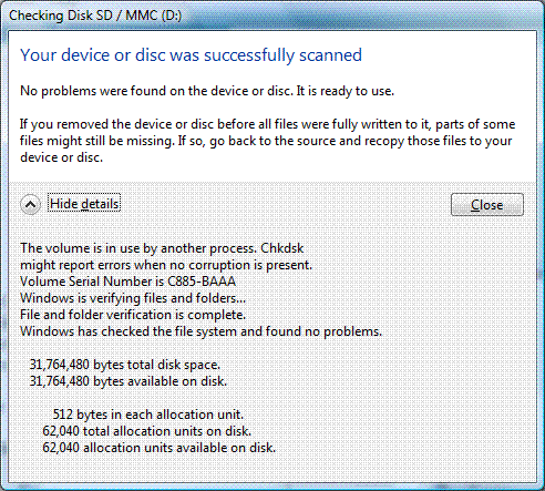

I have a simple application based upon the example "simple slow datalogger" flowchart using a PIC18f4455 on an EB006, with an LCD module (EB005) connected to Port B and an SD/MMC card reader (eb037) connected to Port A. I also have an analogue source derived from the potentiometer of the Elektor experiment module fed in directly to RA0/AN0 to act as the data source.
I am using Flowcode version 4.3.7.63 (professional) with the corrected FAT16.c file. The memory card in use is a Sandisk 32Mib MMC card formatted with 512 byte sectors and is blank.
The jumper blocks are set as follows
MMC reader
Connector block = "A" and System (J4) = "+5v"
LCD module
Connector block = "Default"
As I say, the programme is based upon the example "5 simple slow datalogger" for the EB037 but with the ECIO replaced with the PIC18F4455 on the EB006 and the configuration words adjusted accordingly (see attached files). initially when I compiled the project to the chip, all I got was "waiting for card" on the LCD display. So I added a section to the initialise card loop to display a progress bar. Now I can see that the processor is still active because the progress bar still animates but the programme is still waiting for the card to go active. Any suggestions?
