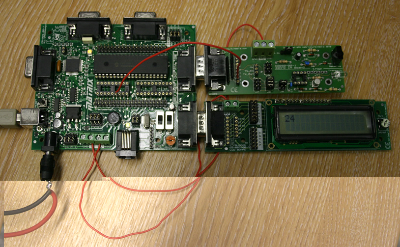

Re: RC5 E Block
I have just tried Sean's program and it is working fine for me. Please can you compare your setup with the attached picture and see if anything is out of place.
Key areas to check.
Oscillator Switch Setting - XTAL.
Crystal - 19.6608MHz.
Wire from pin 6 to RB0 - Pin 6 of the 18way socket is an easy option.
EB006's +V connected to EB060's +V.

Finally managed to get it working. Not sure what the problem was, but tried re-wiring everything and it showing the count on the display.
Not only that its correctly picking up the output from a spare hauppauge tv card remote I had laying around, which is what I bought the card to work with.
Thanks guys great support as always on here
