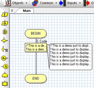

For people with windows XP, 2000 & vista and don't want to edit registry (or just an easier way) I have created two registry files. one which will add the required entries to go from this:
Before Registry update.jpg (31.98 KiB) Viewed 8255 times

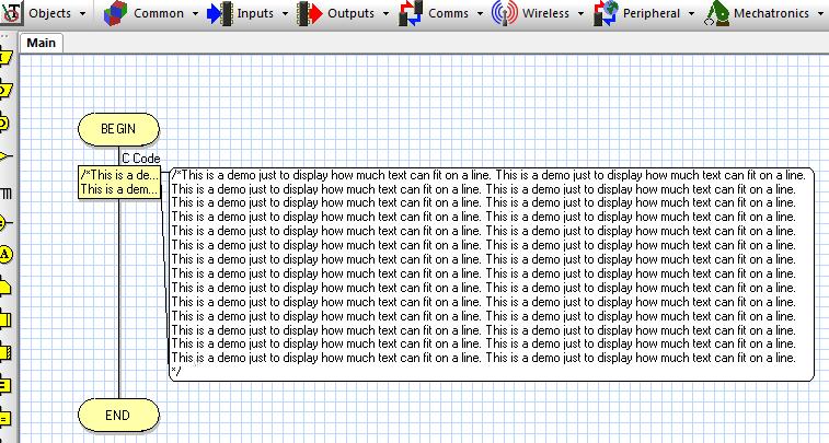

To this:
After Registry entry.jpg (109.49 KiB) Viewed 8253 times
The other registry file will remove the new entries, so changes are undone.
Just double click files to automatically add required entries / or remove (depending on what you require) into the registry.
It is always a good idea to backup registry before making any manual changes, or clicking on any files which make changes to registry for you.
Before posting I have repeatedly used both files to alter registry with Vista and there have been no problems at all.
Hope this is helpful.
