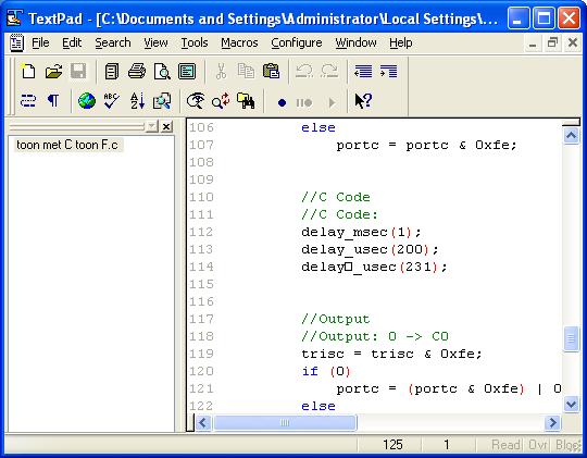

Re: sending C to ff-buggy
Problem is being caused by this in your C code.
delay_msec(1);
delay_usec(200);
delay_<strange character here>usec(231);
Both C code blocks have the same problem. Maybe a unicode character or something else strange.
delay_msec(1);
delay_usec(200);
