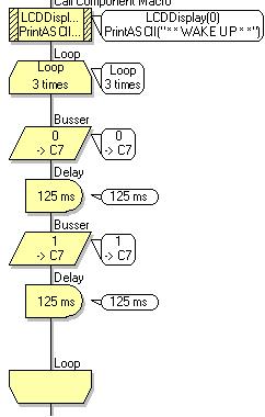

A Couple of things.
You have used count part of loops, so you could always to this:
You could also use conditional loops for keypad detection.

Thank you,
I think my PLC background has helped me allot,
Step7 for Siemens PLC is not much different then Flowcode.
Although it's a bigger program with more options.
And you don't have to think about writing a function twice or more times in a program if you want to continue using it while the program is in a conditional loop. (Accept STL Language in Step7).
And a PLC reads all the inputs before it starts it cycle and writes all the output on the end of the cycle.
I made the change you suggested and attached the (for me) final program.
I want to start over and use what you said, use loops for the keypad.
Perhaps read/write the variables before a Macro is called and write them to the Eeprom after the Macro is finished. So i can use the same Macro for more then 1 function.
Anyway, enough brainfarts.
Medelec35, thanks for you help and ideas.
I attached the Flowcode file for if someone wants to use it.
