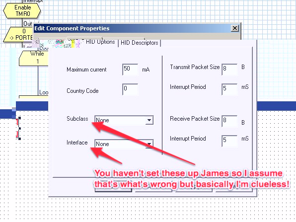

Re: USB using 18f13k50
Hi James,
Right mouse click your HID Component and go External Properties.
You need to tell the component that it is a boot device and what type - I think!
James :-}
James :-}
