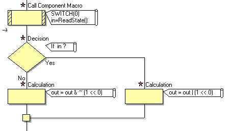

Hi Ben or anyone - can you tell me the way to send Switch No.1 or Switch No.2 or Switch No.3 etc. (up to 16) is 'closed', as an input into RS232. The link and receipt is working fine if I just manually give a character or string to the RS232 input to send. Just cannot work out how to get a switch status and its No. in instead.
Regards,
Chris
Re: Received UART characters to strings
A single RS232 transaction is normally a byte representing an ascii character, but it doesn't have to be.
Each byte has 8 bits which we can tap into to store say 8 digital switch values.
Setting a bit in a byte.
byte = byte | (1 << 0) - Sets bit 0
byte = byte | (1 << 1) - Sets bit 1
byte = byte | (1 << 4) - Sets bit 4
byte = byte | (1 << 7) - Sets bit 7
Clearing a bit in a byte
byte = byte & ~(1 << 0) - Clears bit 0
byte = byte & ~(1 << 1) - Clears bit 1
byte = byte & ~(1 << 4) - Clears bit 4
byte = byte & ~(1 << 7) - Clears bit 7
So now you can set and clear bits in a byte you can read your various switches and update the data in the byte accordingly.
Then transmit the byte via the RS232 serial connection and you can then decode the various bits at the receiver end.
Reading a single bit state
bit = byte & (1 << 0) - Reads bit 0
bit = byte & (1 << 1) - Reads bit 1
bit = byte & (1 << 4) - Reads bit 4
bit = byte & (1 << 7) - Reads bit 7
Repeating this for a second byte will allow for up to the 16 switch values you require to be sent and received.

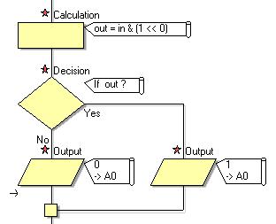

Hi Chris,
Here are two examples using an input icon in single pin mode and a switch component.
And then recombining at the receiver
christoph

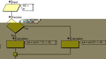

hi Ben,
Transmitter (just done one byte to try) works fine on flowchart but wont 'compile. I get the following message:-
ailure
Return code = 1
Flowcode was unable to compile the flowchart's C code due to the following errors:
If your flowchart contains C code, please review this carefully. If your flowchart contains no C-code or you have thoroughly reviewed the code, contact Technical Support.
FINISHED
Havent had any compiling problems at all before and wondering if it is to do with my ASCII queries which were prompted by the 'PIPE' character ( | ) and ( & which doesn't look like an and! ) and ( ~ ), all of which I didn't realise were on my keyboard!! I had already compiled and programmed PIC 877A successfully (though not getting the reult I was looking for) a number of times and the only differences are the two 'calculation' boxes in the transmitter example (and the '&' for the receiver) containing those characters. Info from web indicates that '|' could mean 'or' and '&' could mean 'and' but I don't know what '~' would be! Can you let me know if it is this and how I modify the calc boxes - or if it is something else.
Regards,
Chris
Posts: 9521
Has thanked: 2585 times
Been thanked: 3815 times
Hi Chris,
~ means Bytewise NOT so its used with Numbers
! means Bitwise NOT so it can only be used with 1 bit
Normally when compiling and you get an error, then error with line number causing the error is displayed e.g
7segx3 count pulse 16F877a V1 test.c(1028): error: unexpected identifier
7segx3 count pulse 16F877a V1 test.c failure
failure
Return code = 1
Have you left the error out because there was no number displayed within brackets?
If that is the case it could be that the place the Flowcode is writing to is no longer accessible.
E.g root of flash drive which is full or too many files.
Folder with no access rights.
Or
Missing semicolon from the supplementary code box.
If you cant find the source of problem, then it is always best to post Flowchart with .C code and .msg.txt. files which are generated in the same directory when you compile to hex or to chip
If you don't want to because its commercially sensitive or you don't want any ideas copied, then its best to PM a person of your choice thike a member of staff from matrix.
I'm afraid
ailure
Return code = 1
FINISHED
Will not help to find source of the problem.
There was an issue with Flowcode 4.3 and 64bit windows 7.
For Return code = 1 and no errors displayed, take a look at:
http://www.matrixmultimedia.com/mmforum ... =30&t=8034
But that was with Flowcode V4.3 and was sorted in V4.5

As for your flowchart, it compiled with no problems what so ever.
So the issue is you do not have the latest version which should be V4.5 or there is an issue stopping flowchart from saving the necessary files.
have you tried creating a new directory and trying to compile form the new directory?
What is your Flowcode type and version e.g professional V4.5 etc?
I have attached the generated hex file for you to try on your hardware.
I have attached the hex file
TEST UART TX .hex
(4.3 KiB) Downloaded 251 times

Hi Martin,
Yes I have version 4.5 professional and this is the very first hiccup I have had but as you will see below, don't think it anything to do with Flowcode directly.
No worries re me not understanding that bit of information, I am such a novice I didn't realise it had a bit 'extra' attached to it anyway - just happy you were very kindly helping me out. Thanks for your reply - just recently got back to the ubiquitous keyboard and have been checking out what you have posted and it looks like you have hit the nail on the head regarding putting flowchart into another directory! Usually, as soon as I have something working, I do actually do that but hadn't with this one yet!
I tried your attachment and it compiles and programmes the PIC with no problem. So I tried MY attachment which again wouldn't compile and neither did my original. So I thought I would follow your advice and try my 'other' directory - oops realising I hadn't specifically put it in one........ EXCEPT that I HAD (temporarily) put it into a file for 'attachments' in case it didn't e-mail properly or whatever. As it transpires that also compiles and loads up the PIC with no problem at all! However, I did notice that MY file was 12 KiB and the one you posted showed a mere 4.5KiB. I assume that this is significant! I DO have a huge amount of Flowcode stuff in that same folder, though all the ones I have just checked seem to compile and load OK. I will use a new folder to progess this now!
Thanks also for clarifying the symbol characters. Are these ASCII? I have a print out which includes 'extended ascii' but it doesn't give the information regarding what |, !, ¦, ~ etc. mean. Is it to do with 'C' code?
I am going to have a file-sort and do the receiver end loaded with extra confidence thanks to your help - very much appreciated.....
