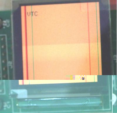

I am new to gLCD, and currently use my ECIO (28P) to control the EB058. In another pages, big brother has recommended good steps and suggestions on how to control EB058, I have tried and successfully turn it on. However, the screen display some unwanted vertical color lines at the left/right side of the LCD as attached.

1) does the attached observation normal? how to remove the color lines?

I had a similar issue with my gLCD.. It appeared to be a bonding problem with the ribbon cable to either board or display. Don't think that there is much you can do about this :? Perhaps try pressing gently on the edge of the display glass and see if you get a change in the line pattern. This will confirm if you have a physical with the ribbon connection
I would sent a PM to Benj at MM with a picture and I'm sure he will help you..
