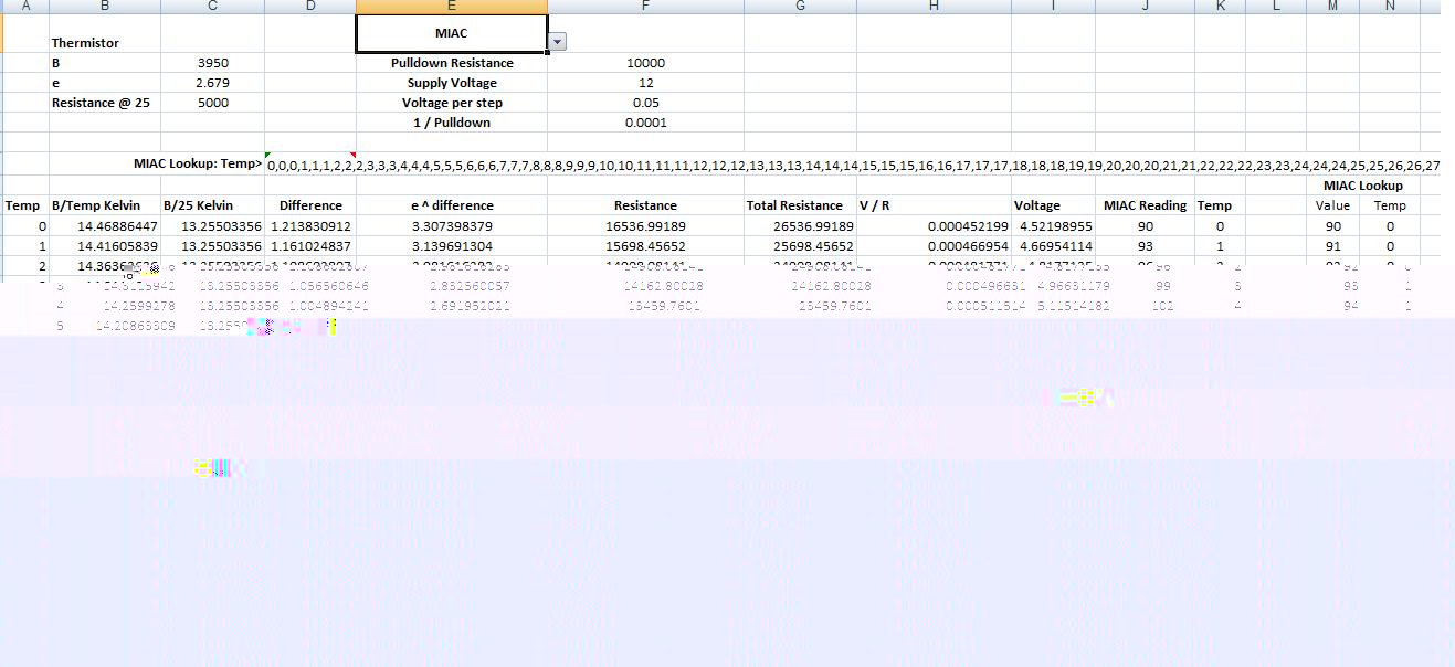

Right here are the files. I think I used this part from Rapid 61-0410 for Β£0.21 but I will try and confirm this, I should have the bag lying around here somewhere.
Here is the spreadsheet file I used to create my look up table. It measures temperatures from 0 to 95 degrees though for my program I was only interested in values between 6 and 58 so these are the values in the seperate table on the right. I then copied this table out into a new file and then saved as a .csv and relayed out the file into rows instead of columns. I think you can do this simply by saving as CSV and then reopening the file and you will be asked how you want it laying out. Then resave (there may be an easier way Im a bit rusty on this new excel). This generated the code to go directly into the array so you dont actually have to type in all those values.
thermistor.xls
(42.5 KiB) Downloaded 639 times
Here is the flowcode file for the MIAC. The MIAC has an internal 10K pulldown resistor so this was taken into account by the calculations in the excel file. If you are using a normal ADC pin on a uC then adding a 10K pulldown to ground will allow you to have the same results with the thermistor as on the MIAC.
TempController.fcf
(16.59 KiB) Downloaded 786 times
The temperature look up table is stored in C inside the supplementary code window which is available via the View -> project options menu.
The lookup is performed near the top of the main while 1 loop. The program is a real time temperature and pump controller. It updates the display with the time and two thermistor readings and fan speeds every 250 milliseconds. It should be quite easy to tailor it to meet your requirements. The file is currently for v4 of Flowcode only.

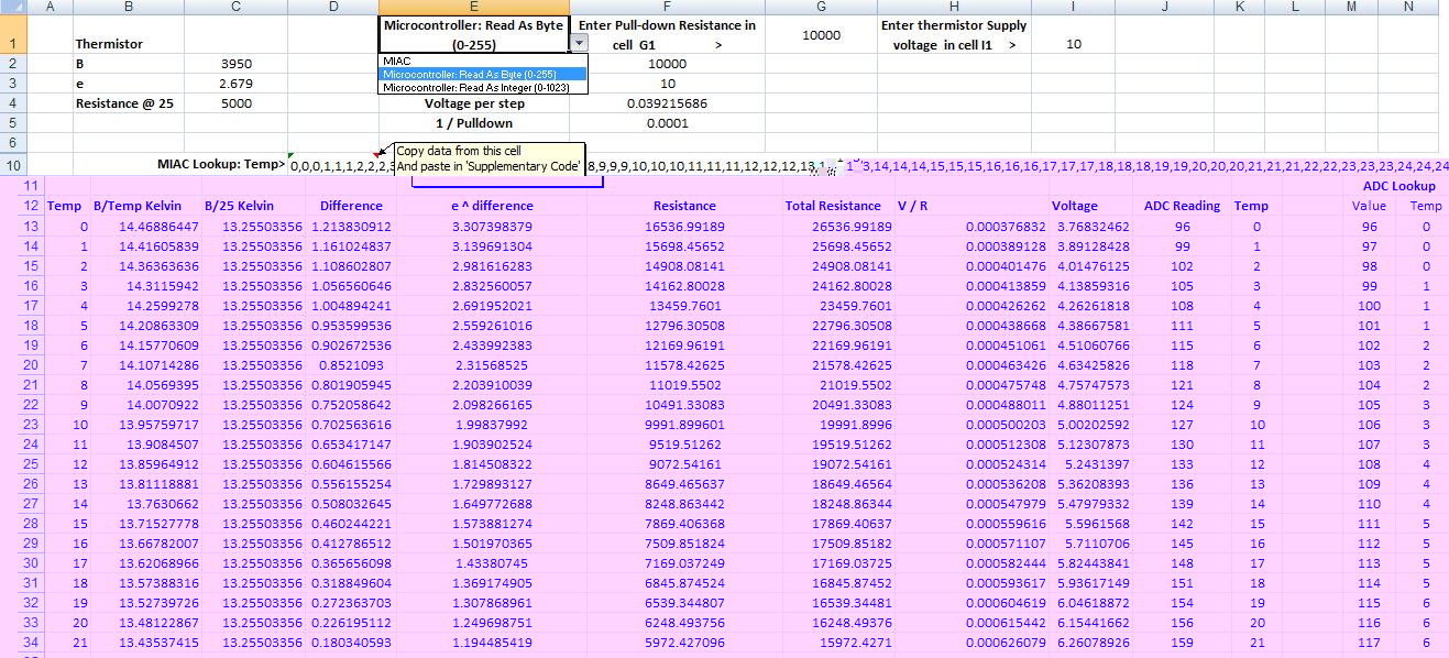

Benj wrote: there may be an easier way Im a bit rusty on this new excel). This generated the code to go directly into the array so you dont actually have to type in all those values.
I have fully automated your excel sheet.
You can aslo apply this sheet to non miac applications where just using any microcontroller. Just click on cell E2 to change, Then Extra prompts will appear (see screen shots)
All you do is:
Enter Values for Thermistor B and resistance at 25 deg C.
Then spread sheet will automatically produce all the data (except variable and semicolon braces etc) in Cell D10 For you to copy and paste directly into Supplementary code window.
Note: you will only see =D7&D8&D9 in excel window, all the data including commas will be copied.
Just delete data not required i.e any commas at the end and data outside range your interested in.
Re: read as int. Not sure how practical this is since I believe the Variable used in supplementary code window can only accept up to 255 chars? Perhaps changing type of variable can allow more?
@Ben. Since you originally posted sheet. would you mind test the automated version and post comments so I can amend where necessary. Thank you in advance.
There is no need to enter any data into MIAC look up columns as this has also been automated.
Try it, just enter a new temperature in A13 and watch all values change.
Hope you like improvements.
Note: Sheet is protected just to stop cells being edited accidentally. No password is required to unlock.

Thanks and your welcome Hope your holiday also went well. If you can put sheet though its paces ,and let me know if you find any problem will be great!
What I like about your sheet is if you use a different thermistor, you just enter new resistance and 25 Deg C and Beta values, then rest is done for you.
