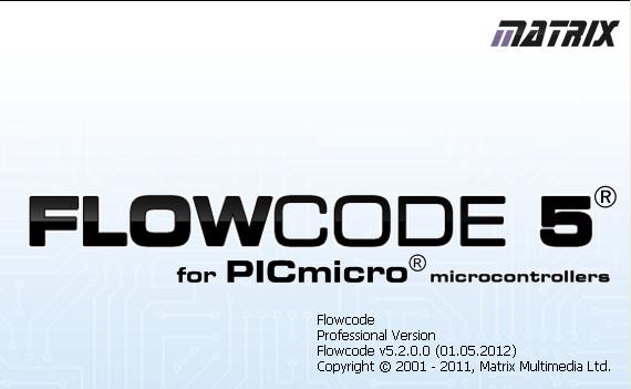

I use the Flowcode v5.2.0.0

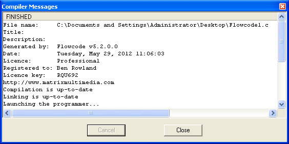

Have a question: download each once only, the second is not correct download!!!! Must turn off the V5 program, restart before we can carry out the new download! This is a V5 bugs? Please help me! Thank you!
Re: CAN in V5 problem
If you are changing component C code or other code outside of Flowcode's control then Flowcode will think the compilation is up to date and simply re-send the compiled file it already has.
You can force a recompilation by clicking the compile to hex button and selecting yes when asked if you are sure you want to re-compile. Then click the compile to chip and the new compilation will be sent onto the target.
Alternatively if you hold shift when clicking compile to chip then this will force the re-compilation message to popup.
