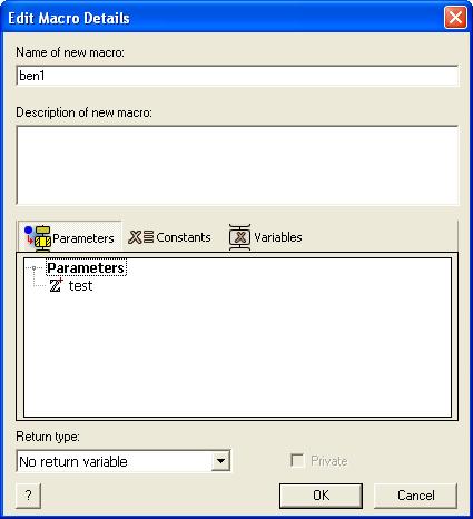

I have just given this a go in v5.2 and the code seems to be being generated correctly.
Here is the C code from the macro I made.
void FCM_ben1(MX_UINT16 FCL_BEN1_TEST)
The MX_UINT16 is the Flowcode unsigned int data type.
