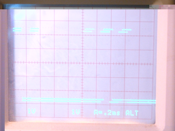

Please find the oscilloscope picture of two microcontrollers, both sending the character "1"
Sending 1 upper_ 4800 baud with 32Mhz and lower_ 19200 baud with 8 MHz_t.jpg
Sending 1 upper_ 4800 baud with 32Mhz and lower_ 19200 baud with 8 MHz_t.jpg (196.48 KiB) Viewed 7163 times
1)UPPER: 12F1840 32 MHz int. oscillator, 4800 baud
2)LOWER: 16F690 8 MHz int. oscillator, 19200 baud
Pay attention: The third peak just in the middle is no peak at all (just introduced by triggering problems).
This seems workable settings to me. Now the flowcode program.
Kind regards
Jan Lichtenbelt
