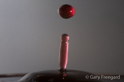

The example I sent was working, not sure why it isn't now, but it was to show you the basic continuous timer from which you could build on.
I have used Flowcode and E-Blocks to create a camera trigger, but this was to capture pictures of water (aswell as wine and beer) drops/splashes.
This required the use of a photogate to detect the drop which started the timer, then at a set millisec interval (this was adjustable) the camera was triggered, using a 40 millisec pulse.
Gary

Hi Gary your pic looks pretty good :-)
