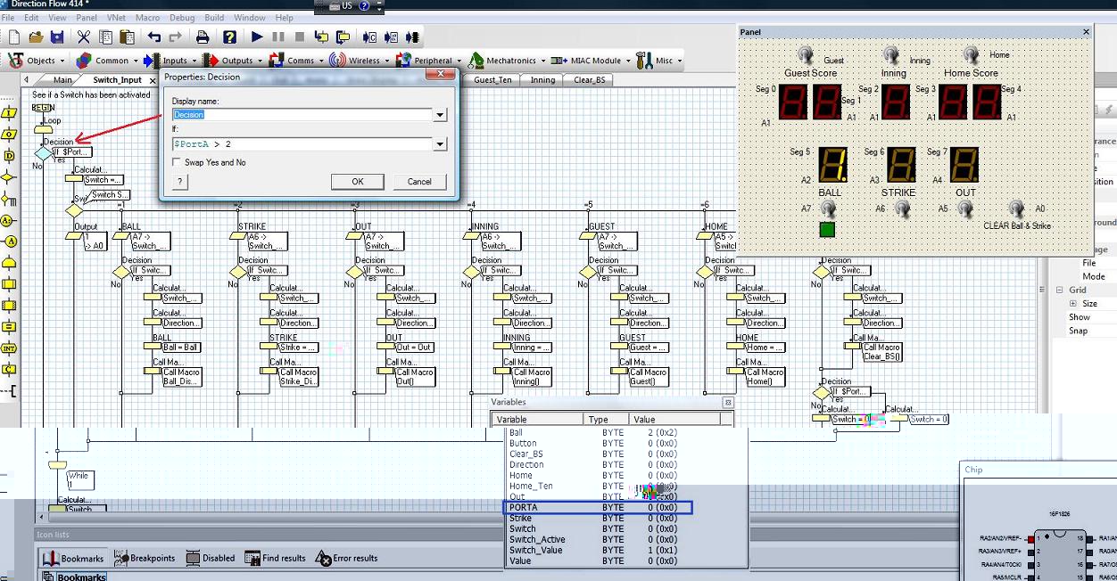

I thought I had a grip but tonight I’m stumped.
I set a Decision statement to see if PORTA > 2 so it can jump into a routine to check which switch has been activated.
I activate ( Ball ) or Port A Bit 7.
So the Decision does activate because PORT A is value 7.
The display for Ball advances then I stop the switch so now PORTA = 0
The Decision FAILS and just keep looping thru all my scan keys.
Here is a picture
Here I have 1 = Ball displayed
The Variable table list PORTA as value 0 but for some reason when I get back to the Loop and into Decision does PortA > 2 it buzzes right past ??
I had to make the image a Little smaller to upload
(212.69 KiB) Downloaded 1333 times

The $PORTA reads the entire port including the pins you are using to drive the 7-seg displays.
I would instead use an input icon with masking to copy the input pins into a variable and then use that variable in your decision icon.

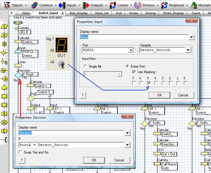

So the decision works the first time waiting for the switch say A7 to go active and then the flow picks up the A7 and activates Ball 1 segment. But oddly why does the Variable window say PORTA = 0 ?
Let me follow you thoughts.
1. use an input icon with masking to copy the input pins into a variable ( So I would need 1 variable to cover the corresponding switches ? )
2. and then use that variable in your decision icon. ( I will give this a try )
John

Hi Benj
Well I think I tried but I tried everything I could think of for the Decision step but I could not get the flow to come in to detect the switch.
I simplified it to be just 1 switch A5 Port A.
Varibale control.jpg (110.71 KiB) Viewed 11991 times
I believe I followed your steps. But I must be missing something.
I spend just about equal time doing images as to working the project.
John

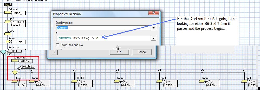

If you want to check one bit (bit 7) your if should be:
($PORTA AND 128) > 0
The other bits are:
($PORTA AND 1) > 0 - bit 0
($PORTA AND 2) > 0 - bit 1
($PORTA AND 4) > 0 - bit 2
($PORTA AND 8 ) > 0 - bit 3
($PORTA AND 16) > 0 - bit 4
($PORTA AND 32) > 0 - bit 5
($PORTA AND 64) > 0 - bit 6
The 'AND' values are the mask. If you wanted to check multiple values on at the same time, say bit 0 & bit 7, the if would be
($PORTA AND 129) = 129

Well with the help of "dbasnett ' outlining the code to determine when a incoming request was sent.
Now I would like to add a little more. it is inspiring to learn more.
Port action.jpg (88.3 KiB) Viewed 11974 times
I tried to read the PORTA variable but I could not read the value. I know the formula works because when I requested a switch the decision returned the result.
now I would like to add a further step and calculate the PortA and return the value so I can speed up the next step. I have 8 buttons to scan and send of to display the correct score.
Seeing the ($PORTA AND 224 ) > 0 results in that decision I would like to take the PORTA value and come up with a 1 - 8 selection so I can go directly to the segment selection. At present I have to scan button from 1 - 8 so If I could jump say to 5 if PortA bit 5 (32) comes up I could - 27 from PortA and come up with Selection 5. I think I would need 8 formulas to cover all the keys but maybe their is a better way.
