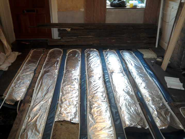

Here are some pics of the installation process.

Excellent, although i have never seen construction like that before with the floor joist almost sitting on the ground, there had to be a ventilation into that space for it to preserve the boards so close to the ground. It also looks like the original building is very old. I have a crawl space in my house, will this system work with a wood-fired stove system?
Re: MX024 - MIAC Controlled Underfloor Heating System
Many thanks :)
Yes the house is over 100 years old and there is no crawl space under the downstairs floor.
This technique could be used for almost any floor system and could certainly be used with a wood fired stove to replace the gas boiler being used in mine.
As long as you have the thermostatic valve and a pump as shown in my diagram to mix the hot water from the stove and the cooler water from the pipes then it should all work really well.
Unfortunately I already had my system in place before I bought my wood burning stove or I would have been tempted to use this instead of the expensive gas boiler.
I suppose the downside to this is you would need the stove to be burning all the time. Maybe a small gas boiler, a solar heater or a ground source heat pump would be a good addition so the system can tick over while the wood stove is off or heating up.

My first house was a Victorian terrace with a floor like that. The previous owner had replaced all the floorboards beautifully using brass screws, as he was a boat builder. When I moved out the new owner was quickly on the phone asking us if we knew the floor was riddled with dry rot. We did not, as a carpet covered it all, but could believe it was possible as there was no or very little underfloor ventilation and the ground was known to be damp as it was a partial basement.

Thankfully I have air bricks under my floor so hopefully the dry rot is not too much of an issue. I do keep checking that everything is tickety boo but I'm by no means a wood expert.
