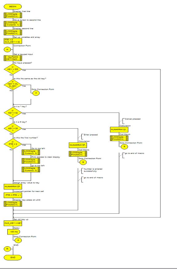

Re: The Row Jumper Keypad v.2
Hi folks. (sorry about my English – I know it sounds sometimes a little out of tune).
In fact the “Keypad 16F877A V1.fcf” (Martin´s <medelec35> attachment) worked fine with my hardware, even changing 16F877A ports.
This proved that neither the Flowcode version nor my keypad were causing the strange “row jump effect”.
But this clearly denotes that my flowchart/logic is somewhat crazy. I copied it from a PDF Matrix document although I (confess) had to invent some parameters that I couldn´t see inside the explanations boxes.
I have included 2 attachments : the above mentioned flowchart and my present and still alive version of the “row jumper kpd”.fcf.
Could someone test it and give me a hint what is going wrong with it ? Thanks in advance.
Hi Karbulla,
The issue with your flowchart are with keypad connections.
When you choose the connections just select the port (not the bits) for Column (columns 2 & 3 + bits 0,1 & 2 )will be automatically selected for you).
Then just select required port for Row A and rest of the connection will be automatically selected.
Back to your Flowchart. you have got: It should be: Martin
