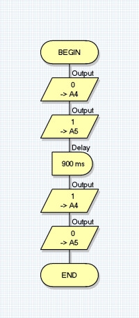

I have almost exactly the same issues as the original poster: output pins that seem to influence each other.
PIC12HV615, FC updated to V5.4
I also have a delay routine that doesn't seem to work in h/w (works in sim).
In searching for a clue I noticed that while the delay() routines were included in the C code, the build reports:
Warning unreferenced functions removed:
FCI_DELAYINT_US in: C:\Program Files (x86)\Flowcode\v5\CAL\PIC\PIC_CAL_Delay.c
FCI_DELAYINT_MS in: C:\Program Files (x86)\Flowcode\v5\CAL\PIC\PIC_CAL_Delay.c
FCI_DELAYINT_S in: C:\Program Files (x86)\Flowcode\v5\CAL\PIC\PIC_CAL_Delay.c
So is this an error? Are the removed non-referenced functions not necessary to use the delay functions??
Thanks for any pointers on this,
jan didden

Benj wrote:Hello Jan,
Have you done the 1 second flasher test to get your delays correct. My guess is that your delays are appearing wrong because the software clock speed and configuration options do not match the hardware.
Ben, thanks for replying. Tried a very basic thing, set two output pins, then delay, then reverse output pins. Appears that it stays in delay indefinitely. Tried both sec and msec delays. Verified same s/w clock speed and speed in config dialog.
Benj wrote:The DELAYINT functions are used to allow you to use 16-bit variables with the standard 8-bit delay functions without having to create a routine yourself. If your passing byte variables or constant values then these functions are not needed.
OK thanks for clearing that up.
BTW I assumed that the GPIO bits 0-5 pins on the 12HV615 datasheet correspond with the PortA bits 0-5 in FC?
jan

Re-installed V4 (which doesn't recognise 12HV615 but does the 12F615 and I assumed it is identical as far as internals is concerned sans the shunt reg.
Same problem. Goes into the delay and stays there indefinitely.
Frustrating!

I think I have isolated the problem.
At the start of my flowchart I have:
asm
// bcf _option_reg, 7 //enable wpup
bsf _wpua, 2 //A2 wpu
If I un-comment the first line, the delay statement later on doesn't work and the program never gets out of the delay loop.
With this line commented out, all works as it should.
Any ideas?
jan
jadiflow
Flowcode v5 User
Posts: 273
Joined: Thu Apr 17, 2008 9:59 am
Has thanked: 19 times
Been thanked: 16 times
Re: Simple problems and mistakes
Post by jadiflow »
If I move the two asm lines shown above *after* the delay, all goes well and subsequent delays also work as advertised.
Still have no idea why it doesn't work with the register settings at the beginning but it's a useable workaround.
