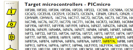

PS my chip is listed here:
[img] [/img]
Thanks for the help Buddy!
Werner
[img] [/img]

Ah fair enough bud. The reason I assumed you had Flowcode student is because of your signatureWerner wrote: Yes I work with Flowcode Professional and do have the function available
