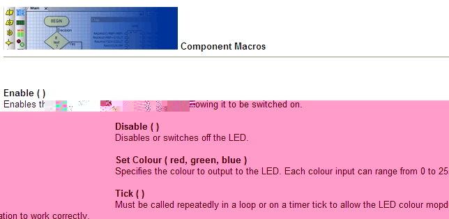

I have a simple circuit that works fine in simulation however when I look at the help file it says that I must use the Tick command in a loop otherwise the LED modulation will not work properley, could anybody spread any light on this please...
thanks in advance
Acestu

Hi Stuart
You need to put the tick command in on hardware.

Hi Stuart
You only need the tick after the RGB led icon

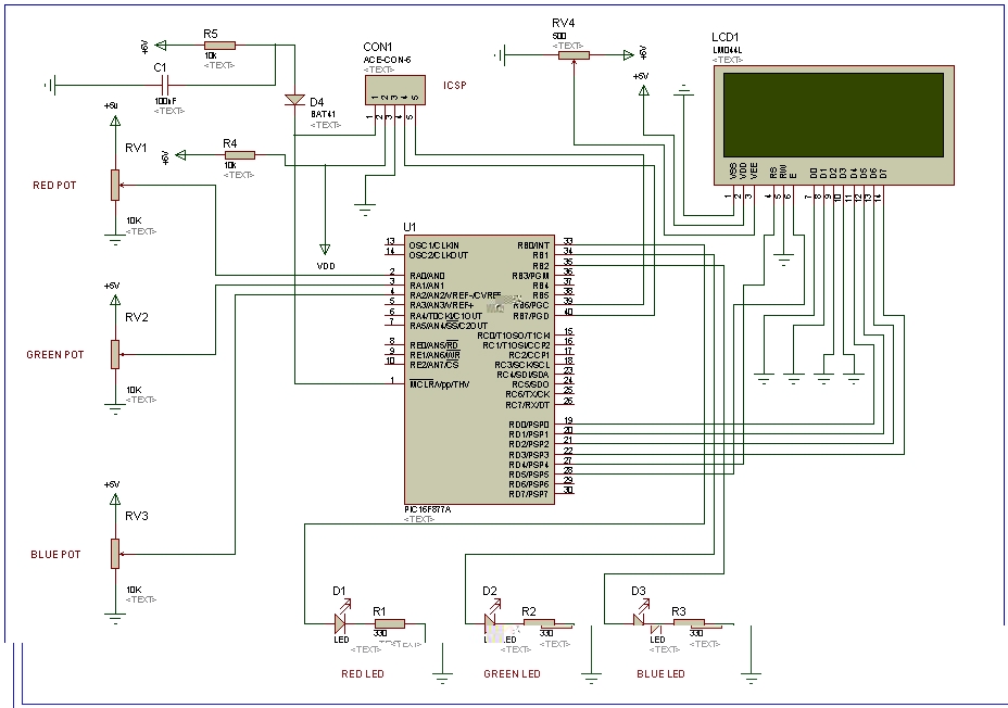

I have put the circuit together but I have some strange results, the leds are flashing on and off, do you think it might be because I am using separate leds and I have the Tick component in the code ?, have a look at the video here:
http://www.youtube.com/watch?v=yn2KfKyz ... tion=share
thanks
Stuart

I am not sure if the circuit is right either, I have had a look at a few other circuits and they have resisters and caps on the pot inputs, if anyone can help I would appreciate it . . .
Cheers
Stuart

Hi Stuart
I would maybe try just the pots and leds to start with, using the programmer and a protoboard (Keep it as simple as possible)
Do not connect the ISP header and maybe even leave of the lcd.

Yes that is what I have done in the video, the pots are showing changes in the lcd but the leds are behaving weirdly ie flashing on and off when I am not even touching the pots..
thanksStuart

Re: RGB LED "TICK"
Thanks for the updated video looks very nice and stable now :D
The timer interrupt is enabled just before you enter the infinite main loop so we can rattle around the loop at any speed we wish but the timer tick will remain constant.
The timer interrupt is used to call the RGB Tick macro which basically compares an internal counter with the current specified values of R, G and B. If the counter is less then the R, G, B value then the relevant R, G, B pin is switched on. If the counter is more then the R, G, B value then the output is switched off. Essentially we have a 3-channel software PWM.
The counter looks after itself and so will automatically wrap around and begin again. As long as the tick macro is called at least (64 ticks * 30Hz) timer per second then you shouldn't see any flickering on the output. You can change how many ticks per cycle if you like by editing a definition but 64 seems to work quite well and allows a large colour selection (18-bit colour). The max possible colour depth with 8-bit variables is 24-bit colour.
