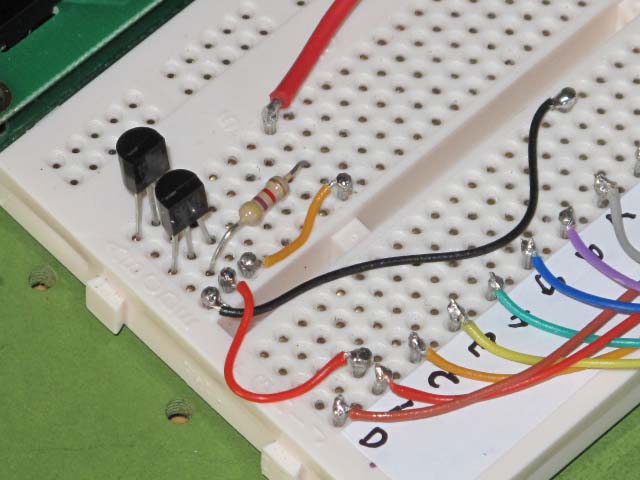

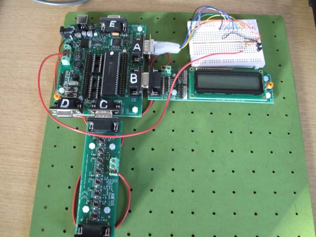

Post by andyduell »
Close up.jpg (70.9 KiB) Viewed 12716 times
Overall layout.jpg (72.5 KiB) Viewed 12716 times
I think that I have included the pull up resistor, can you have a look at the photos and see if I have got the circuit correct? I have been reading all the posts in the forums with any reference to One Wire and also the DS1820 data sheet. I have changed the One Wire connection both on the breadboard and in the Flowcode file to Porta1 because there seems to be a problem with Porta0 in various posts.

Re: One Wire example files.
Post by kersing »
The connections look right. Have you checked the voltage between pin 1 and pin 3 of the DS1820?
To start I would just use one DS1820. Once that works add the second.
If you post your code I'll try to find time during the weekend to find my DS1820s and replicate your setup.
