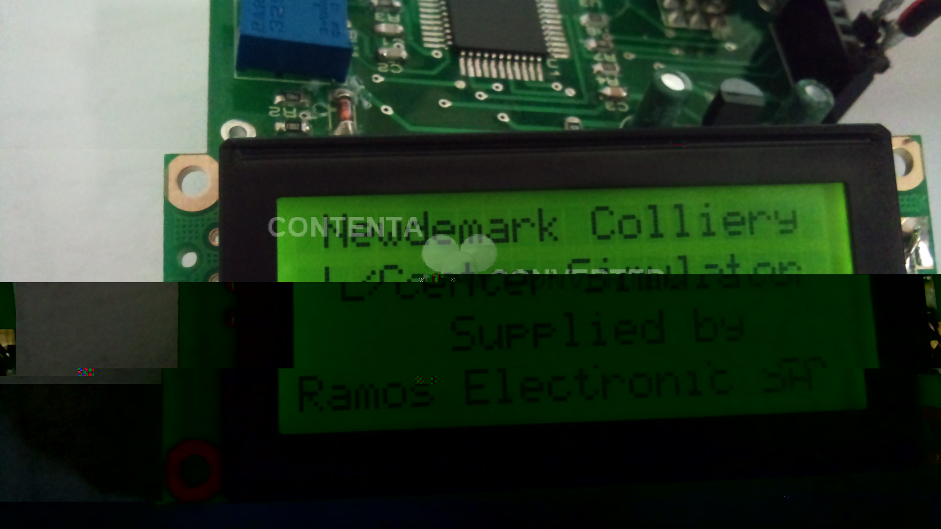

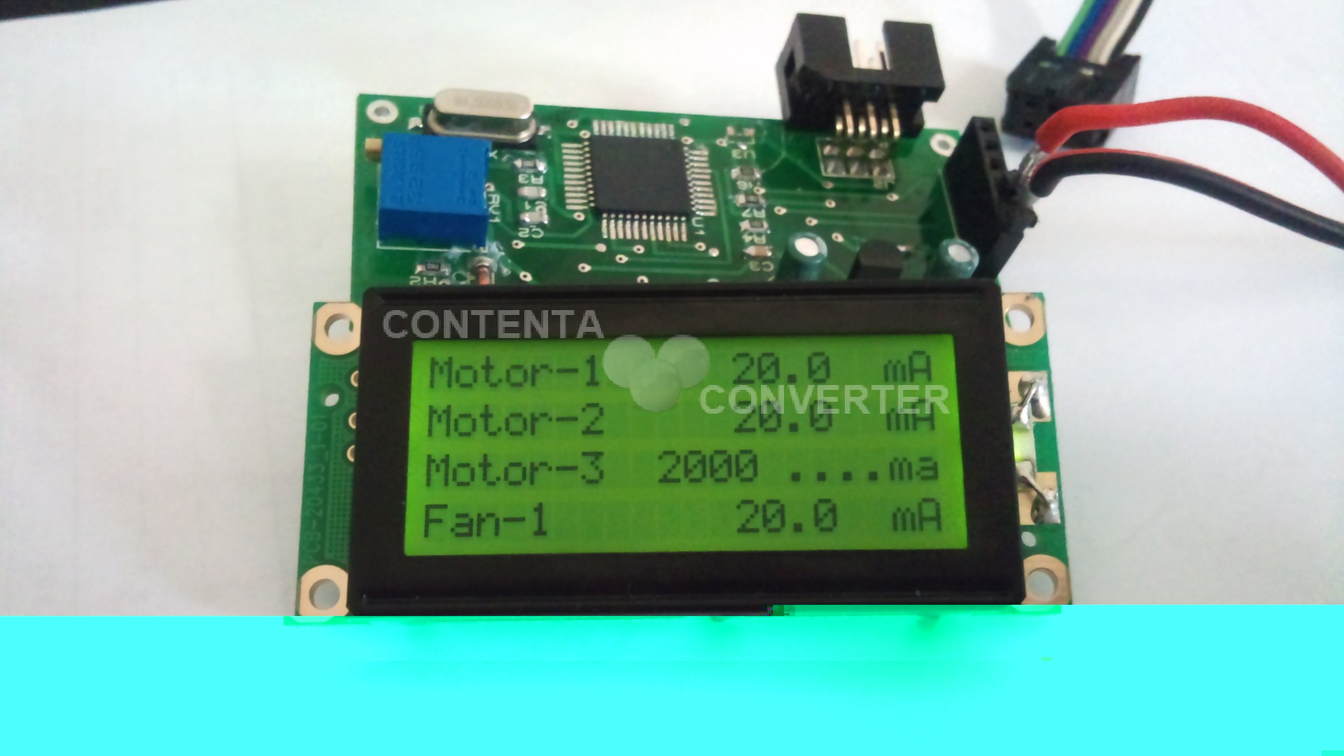

I manadged to get the KS0073 working from Flowcode.
I will post the FCF when I'm donne.
My next hurdle is to split the ADC value into High and Low bites like the old thermometer in flow3. (whatever happen to the thermometer component?)
I need to display the following "Motor-1 20.16 Ma".
With the thermometer component this future was available but the thermometer is no longer available. Is it??
Some pic's of my project.
Pinto
