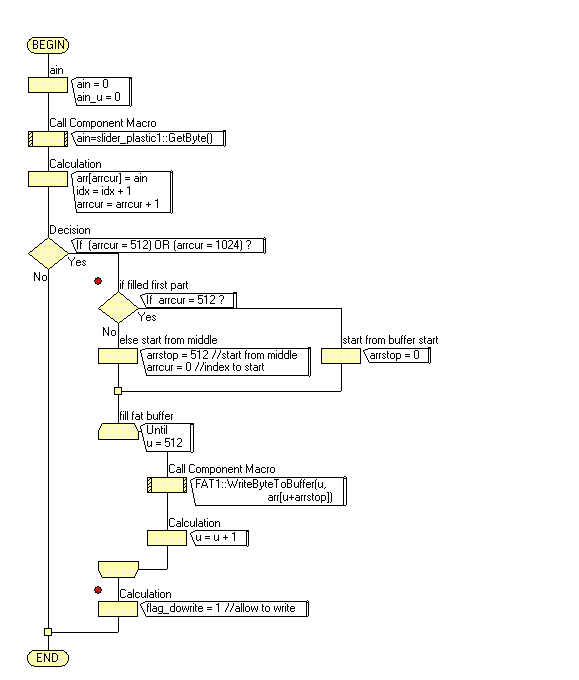

Finally , I've made my own cycled array of 1024 bytes. While it records first half (512bytes) I transfer second half to sd card.
I put copy of array to fat byffer inside the interrupt because it was slow to do copy in the main loop (while it was copying 512bytes and writting it to sdcard, Interrupt was filling the second part and began overwritting first part).
So there's gap in a raw analogue data while it is copying the array to FAT buffer.
Any ideas?
pic24 is running 8mhz. tmr1 is 8khz.
Original firmware for this devcie can record data upto 44khz. How can they do it?
My main flowchart and interrupt flowchart are included below. Any advices?
Any ideas?
PS: when I use GetAverageByte(2,1000) instead of GetByte - chip totally freezes. Same for RawAverage.. What am I doing wrong?
- int
- adcread.GIF (8.72 KiB) Viewed 18016 times

I want to capture analog signal 10.000 times in a second and write the data into SD card.Mathy wrote:What do you want ?
Now the problem is that card writes it much slower than signal capture and I have losses in signal raw.

I don't know how your programs work but there may also be blocking calls which take too much time.
As you are using a circular buffer are you sure this is correctly implemented and the interrupt is firing constantly. I would suggest to ensure your SW is working 100% in hardware as expected, get hold of an LED array and have:
- 2 LEDs that flash every time you read data to each half of your 512-byte buffer (at 8kHz)
- 2 LEDs that turns on at the start of FAT write for each half of your 512-byte buffer
This helps make sure the data is constantly being read reliably and that the FAT is never reading the same block of memory that you are buffering to.
In order to do this add some code like:
And in your main polling routine:
(I hope this pseudo-code makes sense!)
The other thing you can try if the write is just too long is run-length encoding your data or doing differential compression (which may work better), so you have less overhead unless there are lots of large fluctuations on the ADC.
I hope any of this helps / makes a jot of sense!
EDIT: Another thing to note (don't know if this has been covered) is that 8Kz reads into 512 bytes takes 64ms. If the FAT write is 100ms you will always get a loss unless you increase your buffer size to 3 sections, so 0x600 bytes in your buffer.
Jonny
---------- Interrupt ----------
StatusBits = StatusBits & ~((BufferPosition >> 9) << 2)
---------- Read ADC to a buffer ---------
BufferPosition = (BufferPosition + 1) & 0x3FF // Increment scrolling buffer
if (BufferPosition & 0x1FF) == 0 then SDWriteSection = (BufferPosition ^ 0x200)
StatusBits = StatusBits ^ ((BufferPosition >> 9) << 2)
$PORTA = StatusBits // Update
if SDWriteSection != -1 then
StatusBits = (StatusBits & ~0x3) | (SDWriteSection >> 9)
---------- Write to FAT ---------
SDWriteSection = -1
endif
