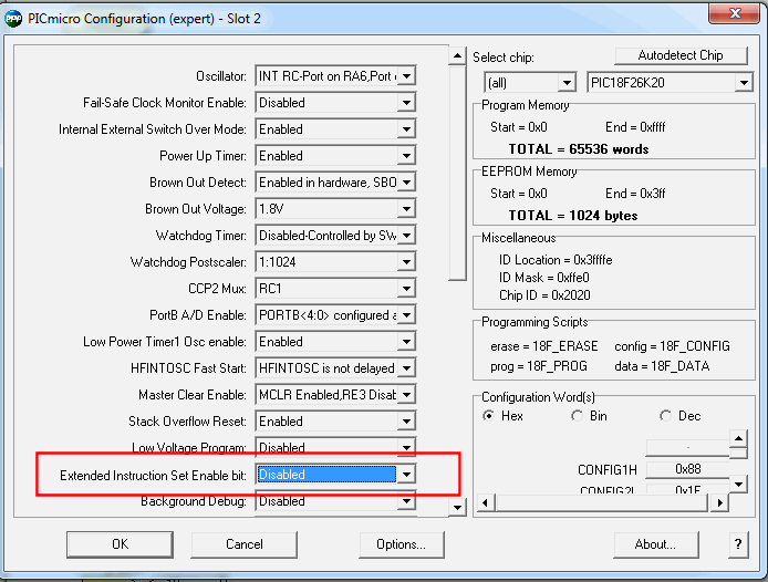

I have three programs that run on a PIC 16F1847 that do not work on PIC 18F26K20.
Whenever these are variables that change values ​​without reason ...
The three programs are quite complicated and utilize a large number of variables.
What do you think of this?
An error in the definition of PIC?
A compiler bug?
thank you

Is a big bug Flowcode for PIC 18F25K20 or 18F26K20?
(34.23 KiB) Downloaded 1072 times
The BUG !!!

Re: I do not understand ...
Post by Kenrix2 »
cubitus54
Flowcode v5 User
Posts: 110
Joined: Wed Jun 19, 2013 7:18 am
Has thanked: 7 times
Been thanked: 32 times
Post by cubitus54 »
thank you very much
It works well :D
