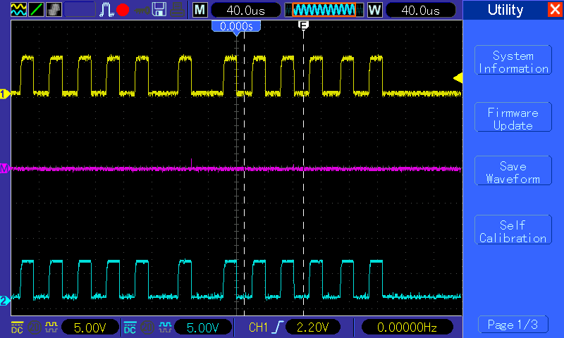

I checked the input/output signals on the 4053 and the data line (Prog_X1 -- RB7_USB) seems to be truncated !
Look at the screen dumps :
Yellow = Output to PIC RB7_USB
Blue = Input that comes from collector Q5 (pin 13 U4)
Purple = Yellow - Blue
I did the same for CLK and seems ok
And also had an "unrecognized chip error" one time in mloader when my probe was on collector of Q5.

Ben,
I think I found a problem !

U4 connects the target programming pins to the E-blocks port or to the programming IC depending on the current operation. Basically stopping the E-block connection from interfering with re-programming.
We have used this setup of u4 on our boards for years without issue and think it is advised to leave unused pins disconnected.
The Prog_X1 signal is bi-directional, It looks like your scope is showing the output and input modes of the X1 signal. The clock signal on the other hand is only unidirectional.

Ooops ! I was little bit to fast
Another thing I saw is that PPP_PGD_O on the side of R92 was sometimes "dirty" at low level. Didn't had time to check the output properties of RA1/RPI17.
Sorry,
Sorry,
