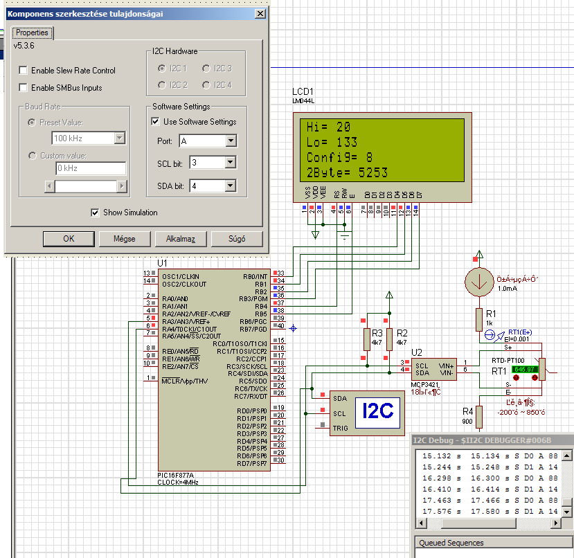

STibor
Posts: 263
Joined: Fri Dec 16, 2011 3:20 pm
Has thanked: 116 times
Been thanked: 113 times
Re: mcp3421 why not? help!
Post by STibor »
nnnnff wrote:mcp3421 why not? help!
The attachment mcp3421.rar is no longer available
I2C is a software component mode.
PORTA3 SCL = SDA = PORTA4
PIC clocked at 4MHz.
(219.39 KiB) Downloaded 846 times
