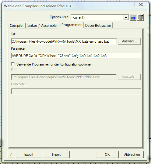

Here are the V5-parameters: AVRDUDE %a %t "%D\%f.hex" "%f.hex" %cfg %c0 %c1 %c2 %c3
Location: C:\Program Files\Flowcode(AVR)\v5\Tools\MX_bats\avrc_asp.bat
In addition I have attached a screenshot of the programmer screen.
Hope that is the information you need.
