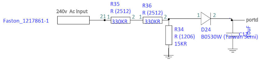

How is your switch circuit wired? Can you send us a schematic for your board?

Hi Benj,
I have attached the input circuit that is used for Portb 0,1,2,3,4,5 and Porta 6 all working as expected, Portd has the problems when reading the input as 4.8v ~ 5v derived from this input method, seems to reed the port a little different, on and off at random when the input switch or switches are held on.
I'm wondering if there is something special about this port on the Pic16F1947 or perhaps flowcodes configuration when defining the port.
