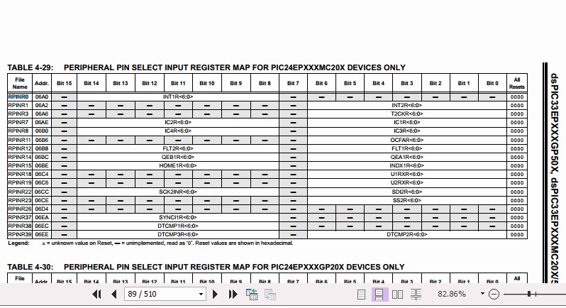

A other Problem with EXTI1 :
If jou test the c_code the value for pps-pin is set in bit0 to bit7 but it must set in bit8 to bit15.....
// Unterbrechung
// Unterbrechung: Aktiviere INT1
INTCON2bits.INT1EP = 0;
RPINR0 = (RPINR0 & 0xFF00) | 20; >>>>>> dont work on hardware
IEC1bits.INT1IE = 1;
// Unterbrechung
RPINR0 = ((RPINR0 & 0x00ff) | (20 << 8 )); >>>>> work on Hardware
Regards Wolfgang

Re: pic24ep128mc202
Thanks for the spot, Just having a look through now to see if these devices need any other fixes.
Re: pic24ep128mc202
Hello Wolfgang,
Thanks for letting us know about the issue.
Right here are all the definition files that this bug effects. Hopefully it should now be fixed but let me know how you get on.
To apply the fix please extract the contents of the archive into your "C:\Program Files (x86)\Flowcode 6\FCD\PIC16" directory before restarting Flowcode.
