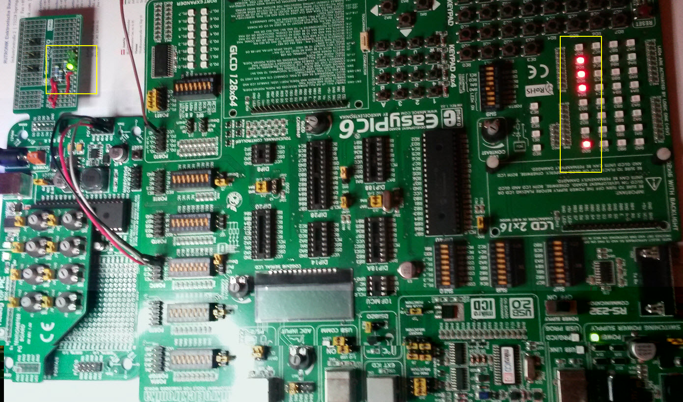

I made a small example for you which show how you can use the RS232(UART) component to make two PIC's talk
you will see that PICA reads a analog signal at AN0 (a byte) then send it to PICB over UART ,PICB receives the byte in the UART Rx Interrupt and disiplay the value of the AN0 signal on PORTB .
as you change the signal on PICA AN0 the leds on PICB will follow the Analog to digital conversion done by PICA.
You need only to change the devices selected to your devices and do the configuration
my Projects use PICA = PIC18F45K22, PICB = PIC18F4585
The Connections between the 2 PIc's is as follows
PICA PICB
Rx --> Tx
Tx --> Rx
Gnd Gnd
this is how it look on my test board
Hope this helps you :D
