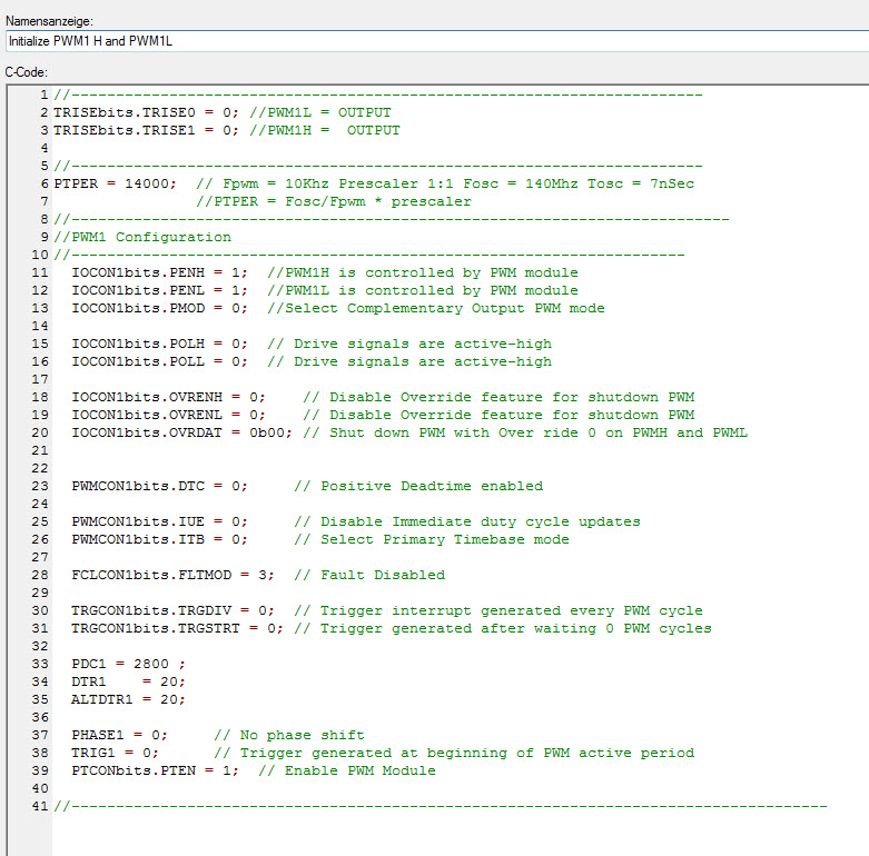

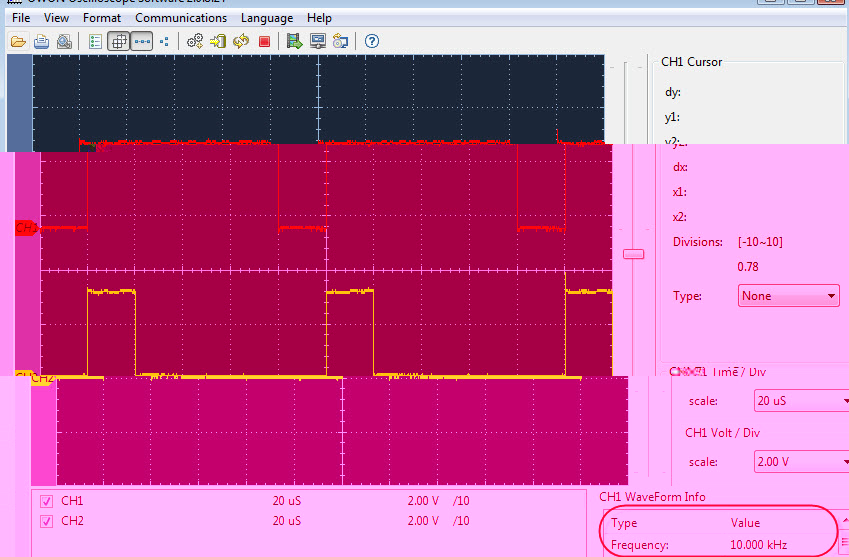

Just to show you an example below is the code I use to run 2 PWM's set at 10KHZ on an ECIO40P16 .
You can achieve any frequency you need by setting up the PTPER register with pre-scalers , then you can use multiple modes op operation for the PWM module check out the Referance manual on PWM for the dsPIC33EP256MU506
it is a matter of configuration to achieve your specification No need for interrupts
Hope this helps you

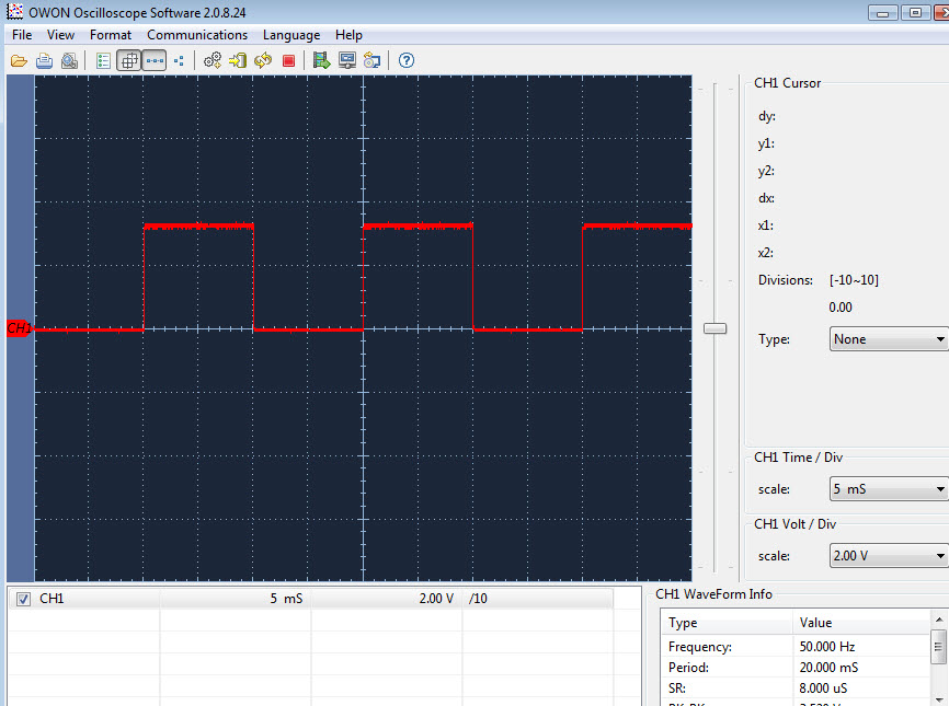

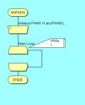

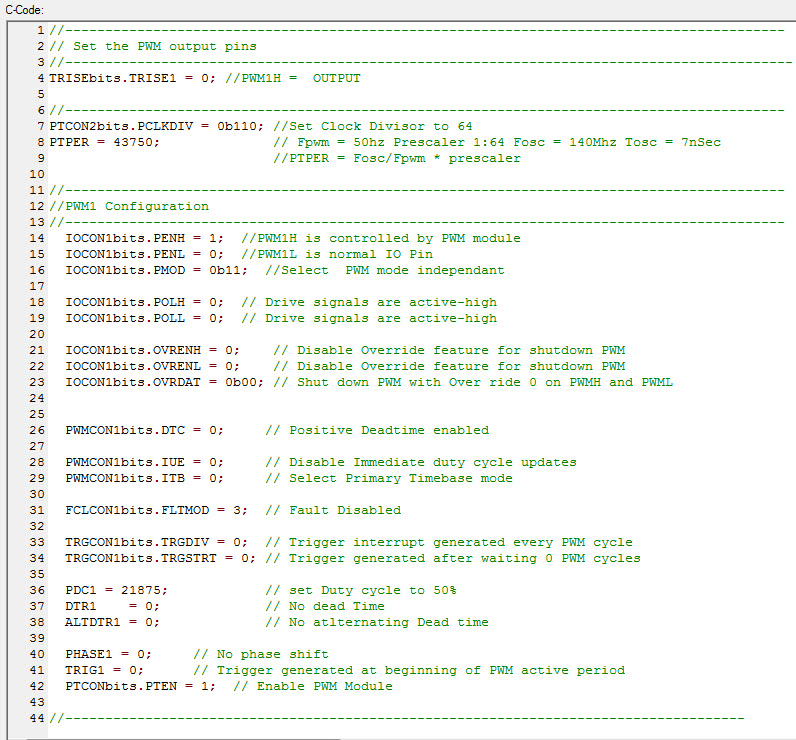

Re: ECIO40P16 PWM Chip Output
Hello
I had a few minutes and I played with your 50Hz PWM below is my FlowCode diagram and the C code I used to get 50Hz PWM on PWM1H(RE1)ECIO40P16 and 50% Duty cycle
Hope this helps you
Hope this helps you
