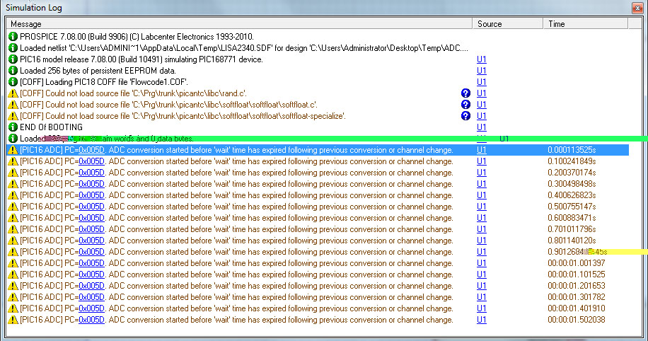

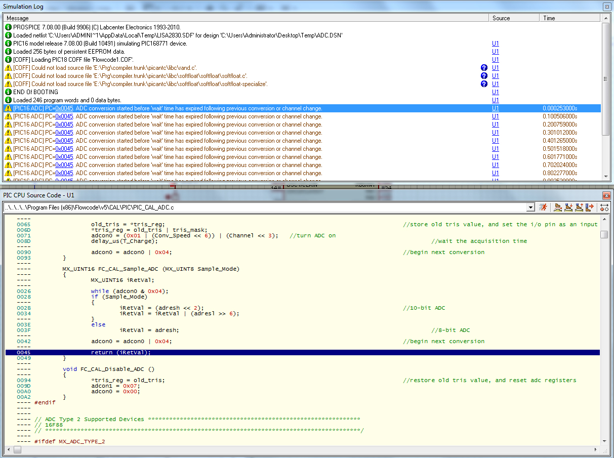

When i use ADC in FC6 or FC5 ,every time i face this error on proteus in simulation log (ADC conversion started before 'wait' time has expired following previous conversion or channel change.)
If clock frequency <= 4MHz then simulation log has did not show this message but when crystal value above 4MHz this message appear ,i have checked it on every conversion speed Fosc/2,4,8,16,32 and on FRC in Flowcode ,
I am not 100% sure but i think there is no such issue in Flowcode V4 .
Simulation log attached below,
Plz describe about this issue,

You're right,default acquisition time is 40 program cycles in ADC properties ,i have already checked that,Increasing it does not matter.
I have a few more tests for this issue, and want to share with you,
There is no such error,If i read a variable(ADC) as, Int, Float and String (but only @ 4MHz clock or below),If clock speed will be more than 4MHz same error appears.
But if the ADC is being read as byte ,then same error appear @ any clock speed,(i mean lower clock speed did not solve this error),
One thing more,
acquisition time did not affect from Flowcode ,but it work from proteus ,that is default 20u,And works something like this:
I programmed a 16f877A chip like this,
Clock 4MHz, program configration words 0x3F3A , ADC ReadAsInt, (and in ADC prperties , acquisition time 40 , Conversion speed FRC),,,,, after compiling it, test on proteus ,that's work fine no errors
But if i change "Adc Minimum Acquisition Time" from proteus (that is in chip properties and advance properties) that was default 20u,
i set it 1u to 21u, these all values working ok,but as soon as this value increase 21u , same error appear there in simulation log.
I am attaching simulation log result here,
Sorry this point was not well defined by me,But You are very capable engineer, so i hope you understood my point.
Best Regards,
Tahir
(798.66 KiB) Downloaded 2145 times
