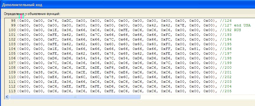

Thanks of course for the link, but in this table isn't present Cyrillics. The matter is that I place codes of symbols of Cyrillics in an additional code, but the compiler Flowcode ignores input of symbols of table 128-255. As a result on the screen - garbage.
- font.JPG (101.97 KiB) Viewed 8577 times

In v6 it will be possible to add extra characters but in v5 there is a fixed font size so you probably have to overwrite existing characters for the code to work correctly. Do you need both English and Russian characters at the same time?

1) Override some of the unneeded parts of the English font data, by far the easiest method. For example you could use characters such as "!~^,.<>' ... and replace with Russian characters. If you only need Uppercase or Lowercase English characters then this would give you an additional 26 characters you can override as Russian.
2) Create your own character set external to the GLCD component and a macro routine to draw your own font a pixel at a time using the pixel functions of the gLCD. This is how the print routine inside the component works.

The first option not absolutely approaches. It is inconvenient to type the necessary text, constantly it is necessary to have before itself the table of a ratio of special symbols and Cyrillics.
As for the second then I not absolutely understood what you meant.
As I understand, at a symbol conclusion, the program transfers this symbol to decimal system of measurement (0-256). But the program is made so that values more than 127 - are IGNORED! How to make that all tablisa of elements was perceived?
