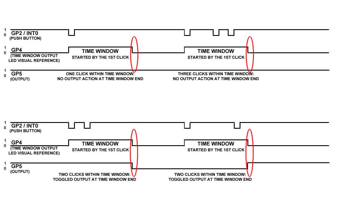

Flowcode flowchart, asm file and function timing diagram (this last one for how it should behave,
not for how it is actually behaving) are attached for better understanding.

Program Description (as it should behave)
Simplified description:
When a push button is clicked, a time window will start.
All clicks on the push button, within this time window, will be counted
(but only the 1st click starts the time window and the subsequent ones will
not restart it).
The time window ends by itself and at its end the program will see how many clicks occurred.
Only two clicks on the push button, during the started time window, will produce an output action
(when the time window ends) to an output pin: It will be complemented
(if it was 0 it will be set to 1 and if it was 1 it will be set to 0).
Any other number of push button clicks, during the same time window, will not produce any output action.
Every time the time window ends, besides producing an output action or not, all is (re)started from the
beginning and the program will be again waiting for new push button clicks.
More detailed description:
All variables are initialized as 0
Pin A5 (GP4) is initialized as 0
Pin A5 (GP5) is initialized as 1
Every time the push button (active low) connected to GP2/INT is clicked,
an interrupt (at the falling edge) is generated.
The program jumps to the INT0_Service macro where CameraControlPulseCount
variable is incremented by 1 to count the push button clicks and, at the 1st one, timer1
( internal clock source and a 1:8 prescaler, 1.907Hz ) is started (to create a time window
of 1.048 seconds as we will see).
On each timer1 interrupt TMR1_INT_COUNTER variable is incremented and, when it reaches
value 2 (1.048 seconds passed) timer1 interrupt will be disabled, gate pulse stopped, and its
registers loaded with 0 (to prepare for the next cycle).
After this the program will see if during the time window there was 2 clicks on the push button.
* If CameraControlPulseCount=2 BuzzerFlag will be set to 1
* If CameraControlPulseCount is different from 2 BuzzerFlag will be set to 0
After this all variables associated with timer1 counting will be set to 0
On main program, GP5 output is controlled
* if BuzzerFlag is 1, GP5 will be set to 0 (to sound an active low buzzer)
* if BuzzerFlag is 0, GP5 will be set to 1 (to stop sound an active low buzzer)
Also, as a mere time window visual reference, during timer1 counting
GP4 will be set to 1 to activate a LED (through TimerIsCounting variable).

What I believe is happening is:
When INT falling edge is detected and INT ISR is accessed then timer1 interrupt is enabled.
This is causing the interrupt flags to be rechecked.
Since INT flag has not been reset as INT ISR macro has not been exited, INT macro is being accessed again!
That would not show as occurring within Flowcode simulator
If I have got that correct then the solution is to enable Timer1 using
Or
Timer1 interrupt can be initilised using interrupt icon at the start of the flowchart just before Main loop.
I have modified your flowchart to test the theory out
st_bit(t1con,0);Or
st_bit(t1con,TMR1ON);I have modified your flowchart to test the theory out
- SymaX5SC1-BuzzerFinder_for_forum 2.fcfx
- (13.58 KiB) Downloaded 304 times
