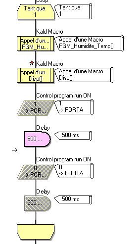

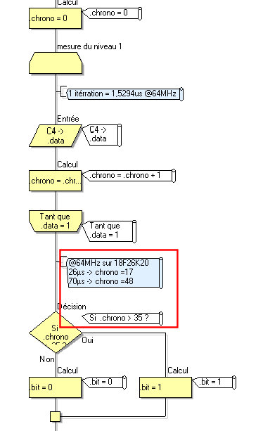

cubitus54
Flowcode v5 User
Posts: 110
Joined: Wed Jun 19, 2013 7:18 am
Has thanked: 7 times
Been thanked: 32 times
Re: DHT11 to DHT22!
Post by cubitus54 »
Must leave some time between acquisitions (eg 0.5 s)
Must adjust the value. "Chrono>35" depending on the speed of the microcontroller. 35 is a PIC 64MHz. At 19MHz, your good value should be around the value 10.
(22 KiB) Downloaded 18468 times
Flowcode V6.1.2.0(11 05 2015)

cubitus54
Flowcode v5 User
Posts: 110
Re: DHT11 to DHT22!
Post by cubitus54 »
For the 500ms
You can try to change the value 8 9 10 11 12 of .chrono,
You can also try changing the first delay 2ms to 4ms

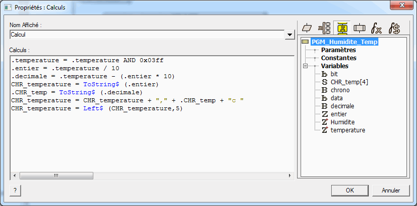

cubitus54
Flowcode v5 User
Posts: 110
Re: DHT11 to DHT22!
Post by cubitus54 »
Hello
For the négative temp.
◎Special Instructions:
When the temperature is below 0 ℃, the highest position of the temperature data.
Example: -10.1 ℃ Expressed as 1 000 0000 0110 0101
Temp.:0000 0000 0110 0101 = 0065H(Hexadecimal)= 6×16 +5 = 101
=> Temp. = -10.1℃
DHT22.fcf
(23.56 KiB) Downloaded 615 times

cubitus54
Flowcode v5 User
Posts: 110
Re: DHT11 to DHT22!
Post by cubitus54 »
Hello
You put a variable or constant with offset
offset = 3 for example (+0,3°C)
.temperature = .temperature + offset
.temperature = .temperature AND 0x03ff
.entier = .temperature / 10
OR
.temperature = .temperature + 3
:D

kersing
Posts: 2045
Location: Netherlands
Has thanked: 553 times
Been thanked: 1081 times
Re: DHT11 to DHT22!
Post by kersing »
Jorgen,
Could you post the contents of the calculation box?
