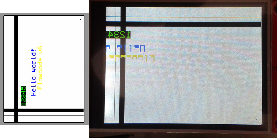

Hello!
Pin "LED" is still in use. If disconneted, got "verbose error" message: "boostc_18F.exe reported error code 1". Portait - landscape problem still exists. Slow update (PIC is running at 64 MHz) problem is still exists.
All the best!
All the best!

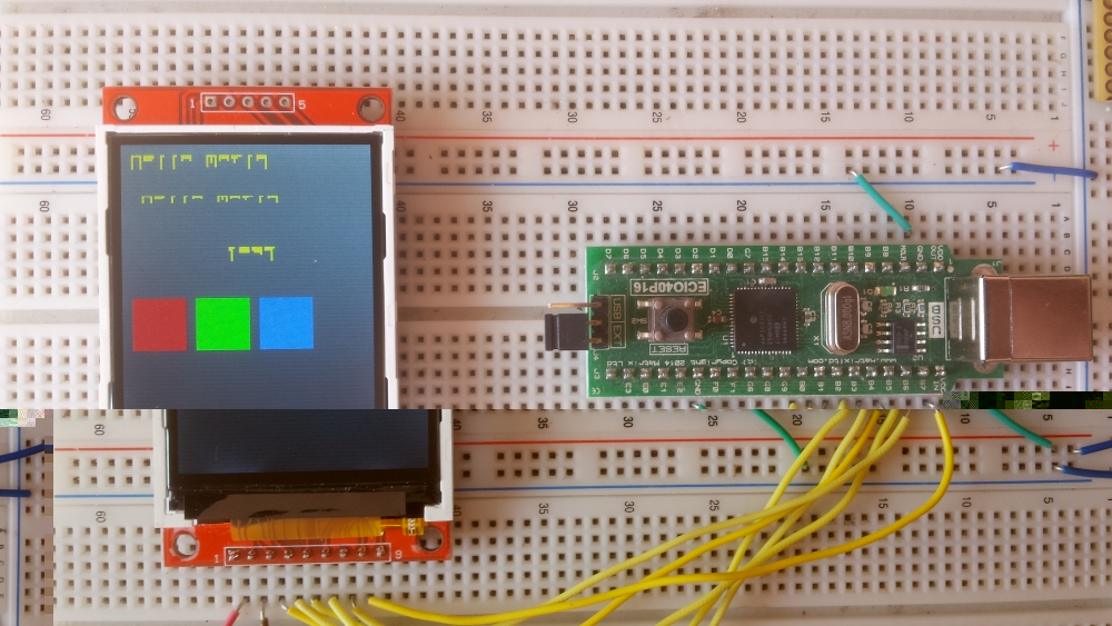

Hello all,
I try to use the same display and it seems to have a problem with displaying a text string or number,
it looks the same way like on the picture from Bachmann, even the numbers are looking very strange.
I can initialise the display and change colors for background and foreground.
I'm using the newest version of Flowcode 6 and also have changed the component file to the latest Benj
has posted here and I'm using a ECIO40P16.
Is there something else to change?
Thank you for any help...

Hi Benj,
here is a picture and the fcfx file and a link to display I use,
https://eckstein-shop.de/22-SPI-TFT-LCD ... 32-ARM-PIC
The Flowcode file just prints two line with text ("Hello World") in different fonts and a number (1234).
But it is not readable on the display, changing colors and drawing some rectangles is no problem.

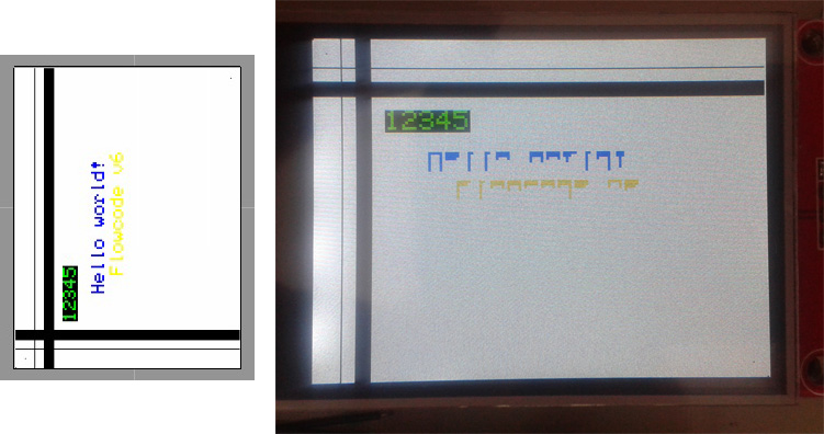

Thanks for posting your files. Here is an updated component you can try which should hopefully solve the issue for orientation mode 0.
Simply copy the file into your "Flowcode 6/Components" directory before loading Flowcode for the changes to be loaded.

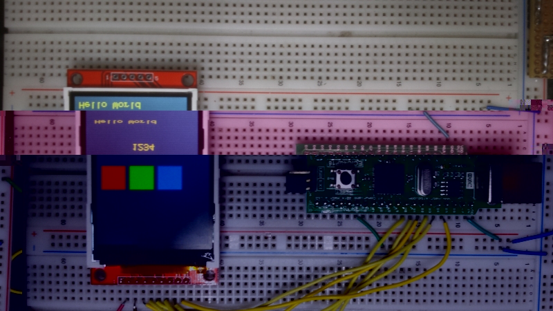

Hi Benj,
thank you very much for the component file,
it works nearly perfect, problem is that the text is mirrored in orientation mode 0 and 2,
in mode 1 and 3 the text is not mirrored.

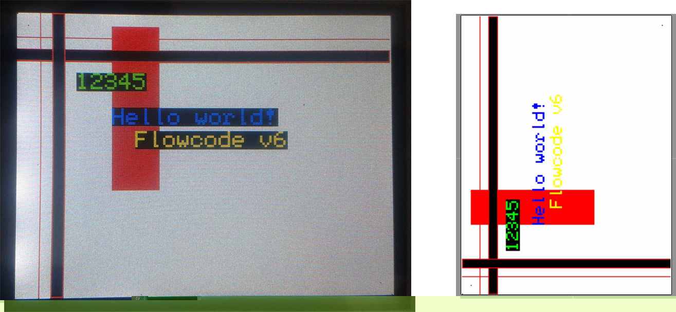

- Bachman
- Posts: 116
- Joined: Sun Sep 07, 2014 11:37 am
- Location: Hungary
- Has thanked: 9 times
- Been thanked: 53 times
Re: ILI9341 after update
Hello!
Result of the last update:
- ILI9341_Geometry_test.fcfx
- (7.81 KiB) Downloaded 488 times
