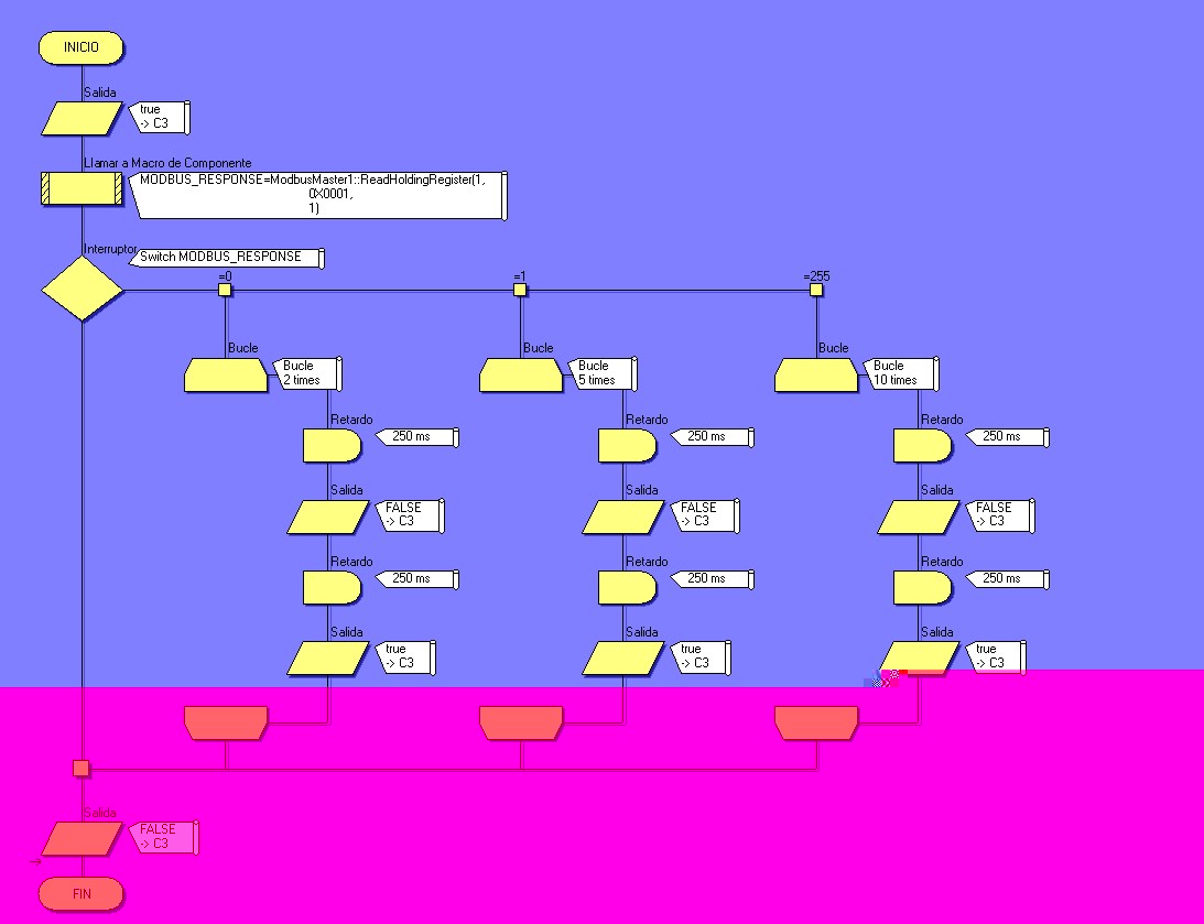

I implemented the modbus component in my project.
I have a Modbus slave emulator for testing. the emulator receives the query and responds but the teacher always gets time out.
Someone has made some example to understand my mistake?
Thank you

Hard to say, but if this is your main loop: seems like youre missing the modbus master initialize function.

Attached the program modbus master file.
In the Main routine, I Initialize including Modbus Master.

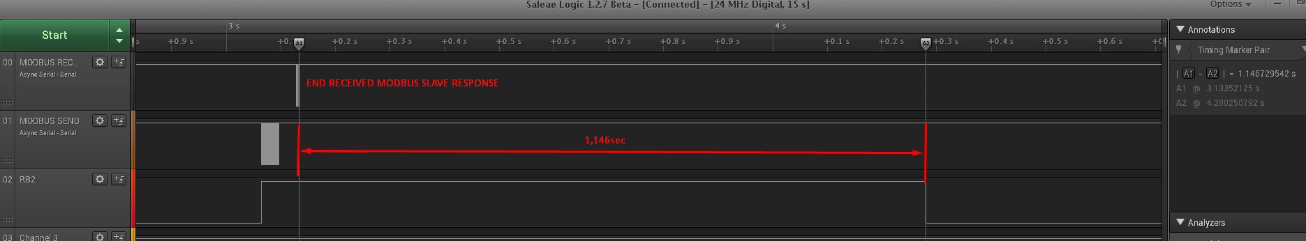

The new component is much faster than the previous but still have a very large pause 1,14sec after receiving the response from the slave.
You can add a variable to adjust the timeout or time out after receiving the answer ??
My big problem is that the micro does two UART communications and also checks and evaluates the data, if a pause or a delay occurs, the micro does not work on your other tasks and are very important.
Deputy capture the graph of time.
Thanks again for your time, I feel very proud to have flowcode, there are a great team in your work.
thanks, thanks and a thousand thanks

Any chance I can see your program?
The component should return immediately after the reply so I am wondering if you are maybe calling the GetResponse macro again after the PresetMultipleRegisters command. I've looked in the program above and you don't seem to be doing this.
Of course it could be something wrong in my time out logic so I will go back through and see if I can spot anything further for you.
Re: Modbus master component Time out response
This component now has a new property named Receive Timeout. You should be able to adjust this until the delay has been eliminated.
Modbus.fcpx
(16.7 KiB) Downloaded 436 times
Still not sure why we are not jumping out of the routine at the right time.
